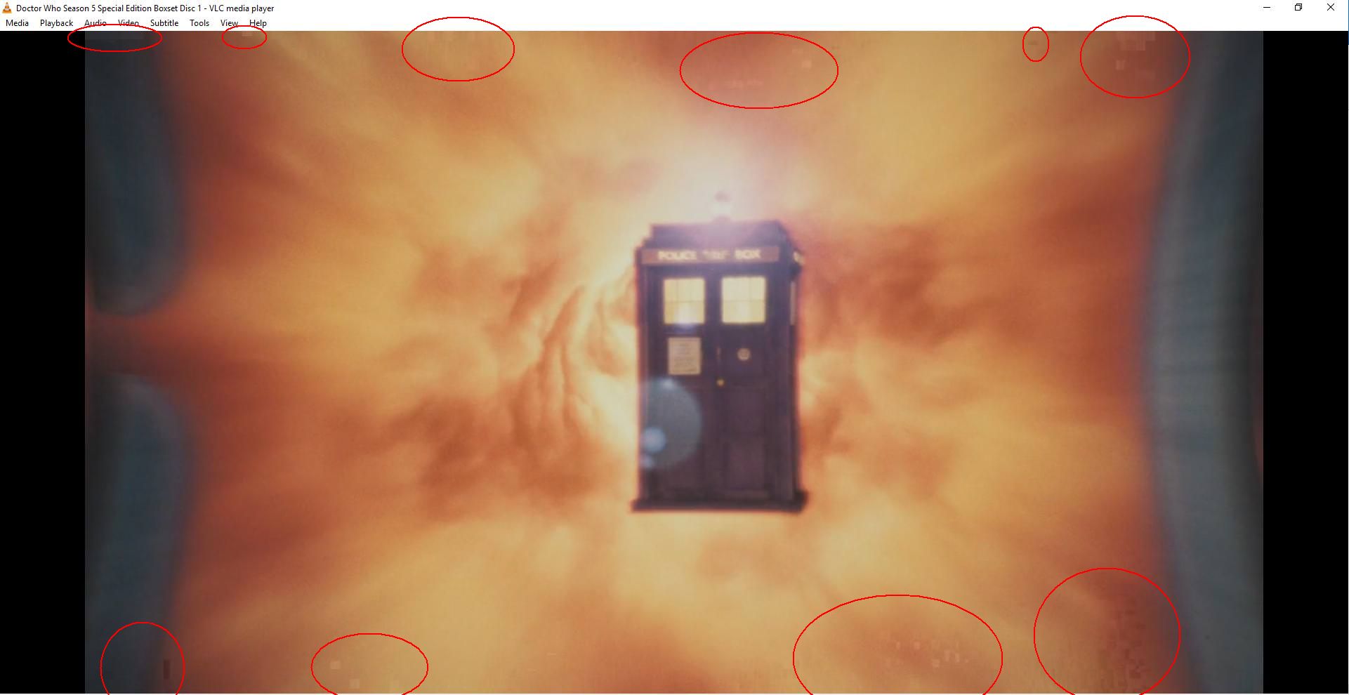

Forgot to mention yesterday that I confirmed that decoding using DXVA decoder with Intel doesn't fix the pixelation issue, only AMD.
After tweaking the settings I finally hit my preferred balance of size and quality. Picture quality is excellent. Only thing I don't like is there's a slight jerking during scenes where the camera slowly pans. Not sure what I can do about it. Might be the deinterlacing or the 29.97 fps. Anyway it's not as noticeable as the pixels so I guess I'll put up with it.

It looks like Noise or mild artifacts, it's due to how the Blu-Rays were mastered.
Not sure if HandBrake has a pure artifact removal filter. hqdn3d can remove the noise. Start at lowest settings and see if it's been removed. If not head to the next setting. You may also want to sharpen the picture slightly after using hqdn3d. -
Revan654, we already confirmed it is a decoding issue. It is a well-known issue with the libav/ffmpeg VC-1 decoders (well, until ffmpeg fixed it literally 4 days ago). OP confirmed it by testing against the DXVA decoder which didn't show the same artifacts. With Blu-Ray bitrates you don't have such extreme artifacts.
