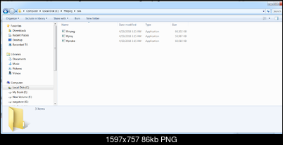

    Maybe I'm not installing or replacing or doing something wrong. I basically just copied and pasted the "stuff' from the zips files into the folder just like the video in my first post instructed. 1st is the original, 2nd is the version poisonsdeathray suggest, and then now what you see is the 32bit version you suggested. For some reason, I still can't get it to work ...
    ffmpeg -i video.mp4 -nlmeans output.mp4
    Note: I already have ffmpeg command window encoding some files (does this make a difference). Should I stop the encoding process on those?
Name:	ffmpeg help etc a.jpg
ID:	45331Click image for larger version
Name:	ffmpeg help etc b.jpg

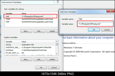

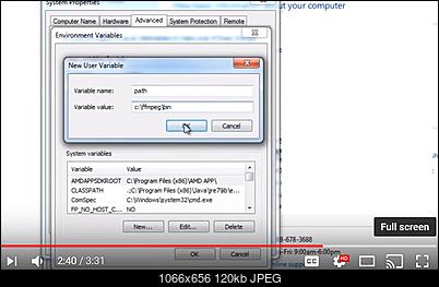

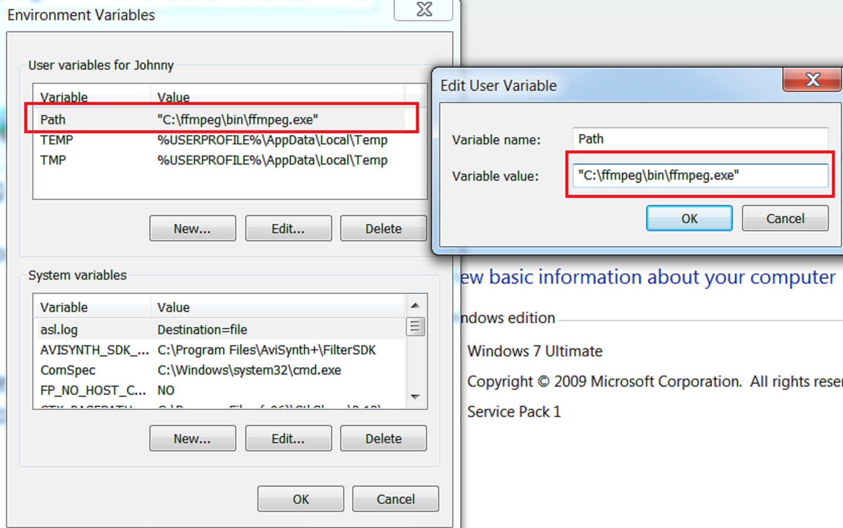

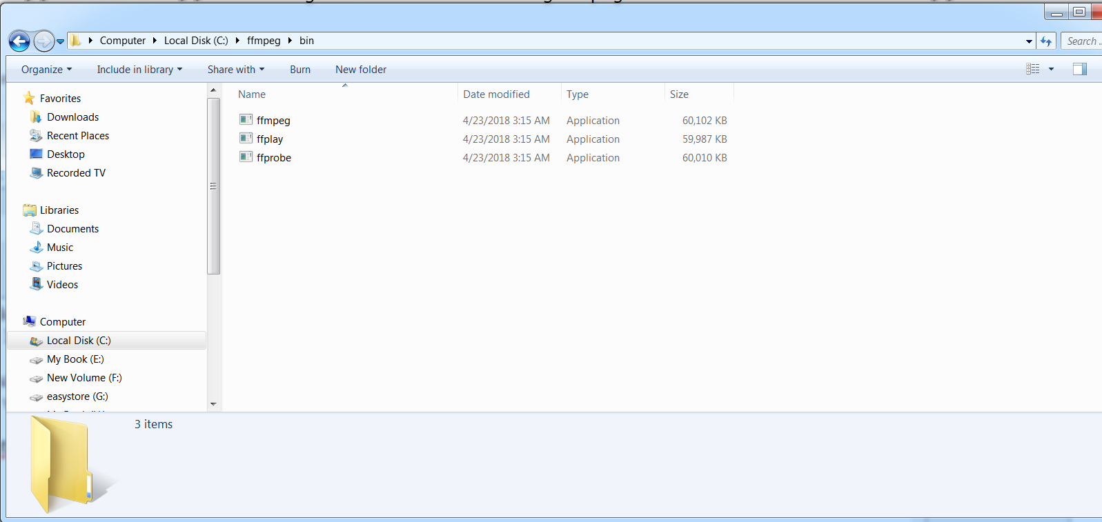

    May 2016
    So the following looks like it works, but it required me copying and pasting the ffmpeg.exe into the folder with all the videos. Then I deleted ffmpeg.exe from the same folder, ran command and it didn't work.
    Is there a way that I don't have to have ffmpeg.exe in the same folder as the videos because I following the directions in this video got ffmpeg always working.
    I tried deleting the environmental variable, etc. etc. already and redoing the steps in the video with the ffmpeg that you suggested, and still not quite working. In order to get it nlmeans to work, i need to copy and paste it into the folder with all the videos.
    https://www.youtube.com/watch?v=xcdTIDHm4KM
    This is where the original ffmpeg.exe application is located.

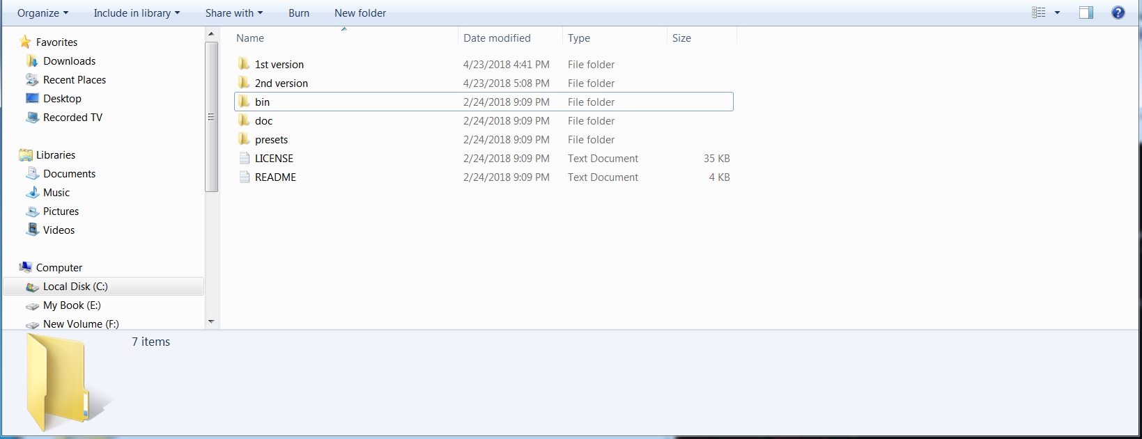

Name:	ffmpeg location.png
    I also have this going so I figured this would be enough.

    May 2016
    Yes. See the post #10 above about specifying the ffmpeg path
    Or you can setup the environment variable correctly
    Is this wrong?

  14. For the environment variable - The path should not include the executable. It should only be the path, no quotes.
    I have mine setup as a system variable, not a user variable
    May 2016

    May 2016
    [Attachment 45337 - Click to enlarge]
    [Attachment 45338 - Click to enlarge]
    Even though I have nlmeans working, I’m still curious as to why the environmental path or whatever it’s called isn’t working. The first image shows the location of ffmpeg application. Even though I’m swapping out the different versions of ffmpeg, it does nothing. Having the updated ffmpeg (60mb) version in the bin folder doesn’t update in the cmd command prompt when I type ffmpeg -version. It’s still the 2015 version. But when I swap out the ffmpeg (30 mb) located in the Imagemagick folder with ffmpeg (60mb), then it works.... by typing ffmpeg -version ... shows 2018 version.
  17. You have another environment variable that tells windows to look in the Imagemagick directory . I don't know how it works in terms of priority but it's probably looking there first. You might have to clean up your variables, or organize it differently
    In addition to specifying specific paths in your commandline, you can also rename ffmpeg.exe to indicate different versions. For example , a common distinction is x86 and x64. You need to use the x64 version for x64 programs, but some x86 programs and pipelines still require the x86 version. For me, I rename my x86 version because I use the x64 version more frequently
    Sometimes there are specific versions that do specific things or build with different libraries (I have multiple versions, some of them need to be compiled separately because they contain "non free" or non distributed libraries), so to distinguish between multiple versions on the same system you need to keep things in order or have a way of using the version you want specifically
