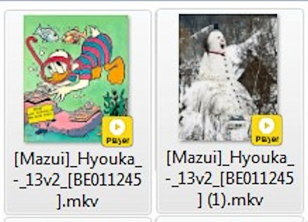

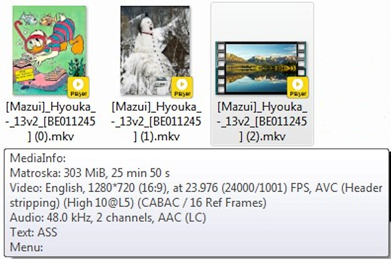

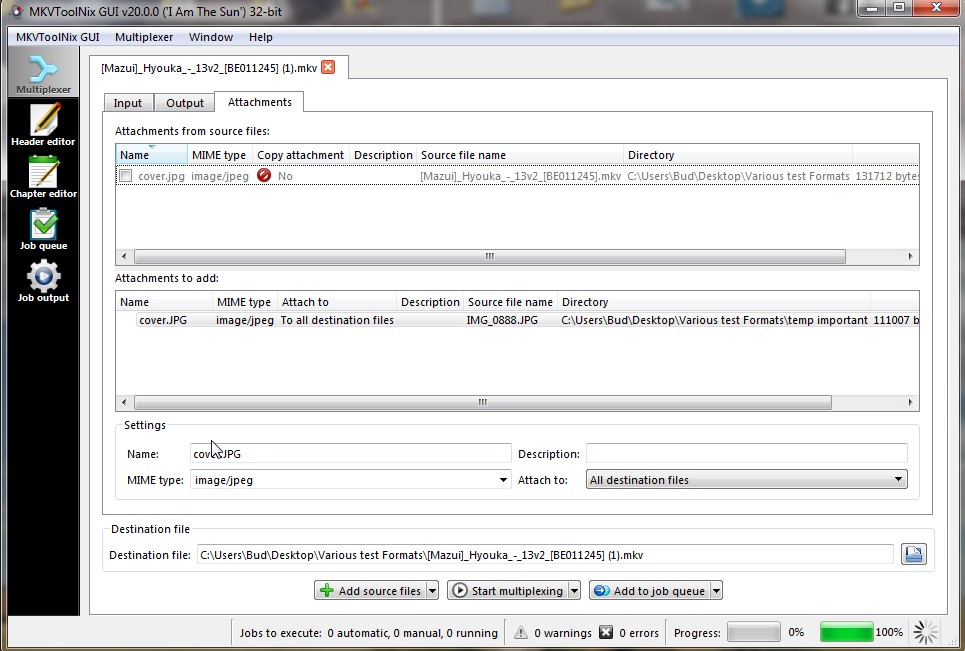

    Just tried MKVToolNix Gui and used an MKV that I had already changed the Thumnail to Scrooge McDuck. I disabled the MKV's original Attachment and added a JPG that was 378x478 and renamed to 'cover.jpg' as described at https://www.matroska.org/technical/cover_art/index.html (since my folders show large thumbnails).
    I remuxed and got a new file with the new thumbnail.
    [Attachment 45311 - Click to enlarge]
    [Attachment 45312 - Click to enlarge]
    UPDATE:
    Just used FFmpeg and a 605x327 JPG and created a third thumbnail, same MKV.
    ffmpeg -i <input.mkv> -c copy -attach cover.jpg -metadata:s:t mimetype=image/jpeg <output.mkv>
    ATTN: The first time I did not call it 'cover.jpg' and it showed default thumbnail.
    [Attachment 45313 - Click to enlarge]

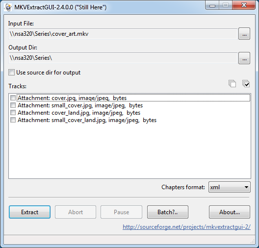

    That's not working either. I downloaded and installed the newest MkvExtractGUI, but every file I load in shows NOTHING that can be extracted. Even if I run MkvExtractGUI as an administrator.

    I just tried on another Windows 10 PC. No matter what file I load into MKVExtractGUI, I get an error about an access violation and no files of any kind available to be extracted.

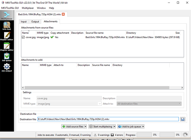

  25. I opened this sample file im MKVToolNix and you can see the four jpg inside the MKV, but I don't know if there is the possibility to extract it. Would be interesting for me, too. Maybe someone can help me.

  29. OK. So I installed and ran MKVCleaver. I extracted the attachments from that cover-art.mkv file. What's being shown to me is either cover.jpg or small-cover.jpg. But the properties on those files are exactly the same as the properties of the cover.jpgs that I'm trying to use. This makes no sense at all. Maybe I need to try running it on a Windows 7 machine - although if it's failing on both Win 10 and Kubuntu, I'm doubting the OS is the problem.

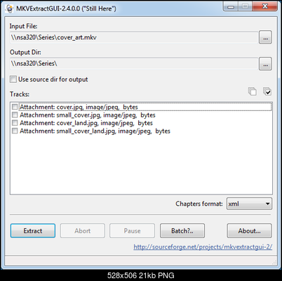

    The latest version of MkvExtactGUI shows this for that file:
