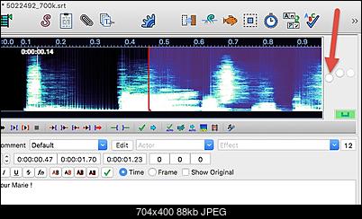

    I have an issue with Aegisub.
    I have no idea how, I pressed a key or several at the same time when my mouse was on the spectrum (the thing up right, I think it's called the spectrum), and now it's completely zoomed in (see the screenshot attached). I do not know if you can see how it is now. It's zoomed in and therefore I can not work with it.
    The spectrum is bigger and I can not reduce it to its previous aspect.
    I uninstalled and reinstalled completely Aegisub twice, but it is still the same.
    I tried everything to put it back to normal...
    Please help
    Any help would be very much appreciated.
    Thank you very much !

  2. You can adjust the zoom with the zoom sliders. The 3 sliders to the right of the audio spectrum in the screenshot
  3. Thank you @poisondeathray, I didn't even know there were sliders. They don't seem to work, I can't move them, neither there is a "vertical line" to move them on

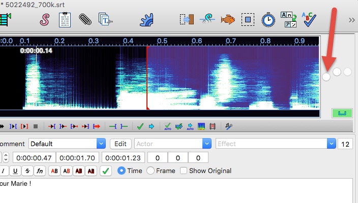

  4. To be clear, it's the horizontal zoom slider . The 1st slider . The red arrow points to it in this screenshot
    Slide up to zoom in, slide down to zoom out

    This looks like the mac version - maybe something broken in the mac version ?
  5. Yes, this is the mac version.
    I can not slide it up or down, neither of the 3 buttons.
    I guess something is broken in the mac version then...
    Not sure I can solve that, anyone?

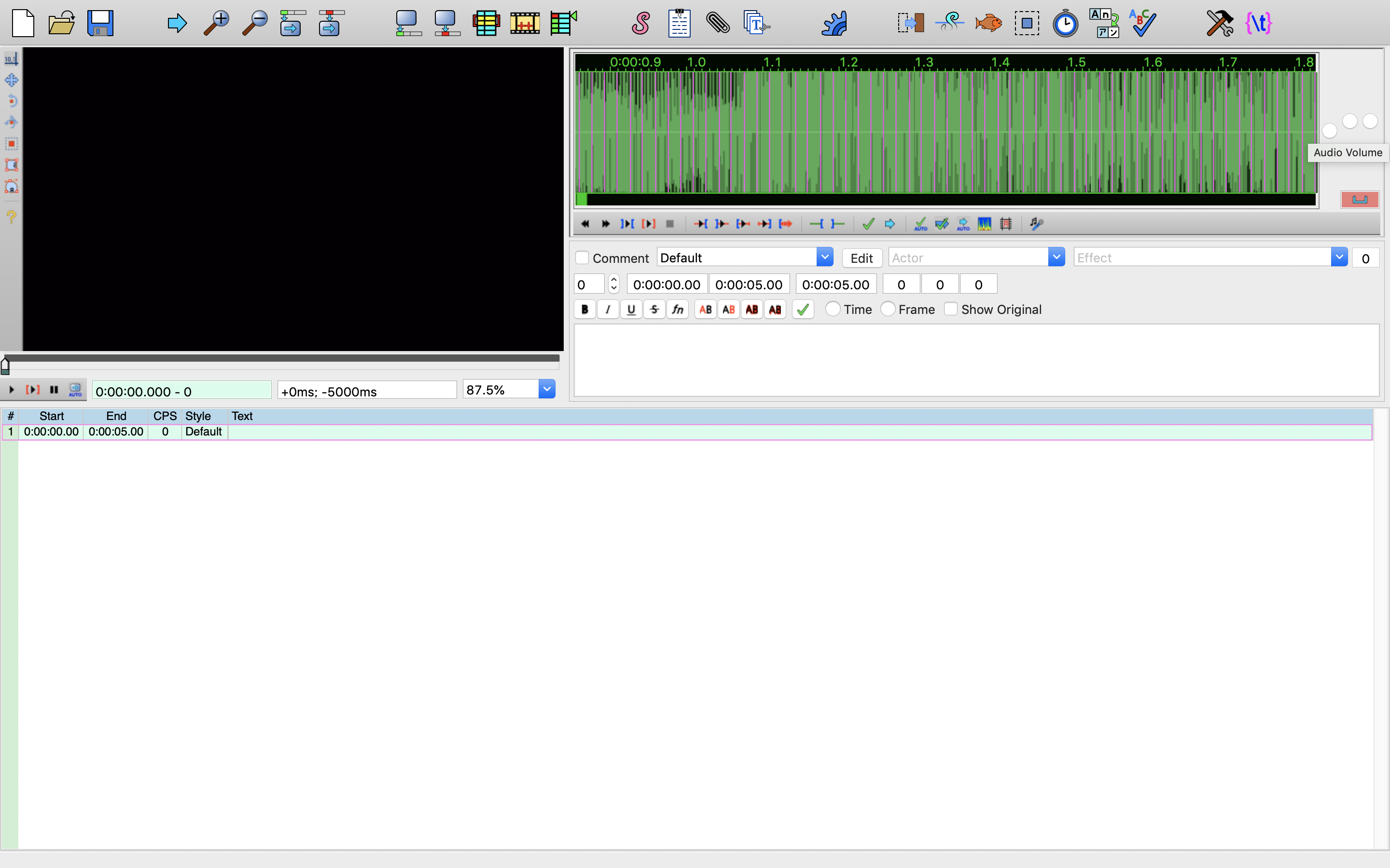

  18. Hello Everyone, I also have a problem with the program
    [Attachment 47974 - Click to enlarge]
    I upload the video and audio into the program but the audio sound is crack
    (I hope that you can understand from the picture, the wave go very high and low, it's looks abnormal. The sound is really crack)
    I try to fix it and check every setting but it does not work. I cannot find the reason.
    I also did try another audio file, it cracks as well. It happened to all file that i open
    Does anyone know how to solve the problem? I'm really worried about it, I was trying to fix it for the whole night.
    btw. Im using 3.2.2 version on mac
    Thank you in advance

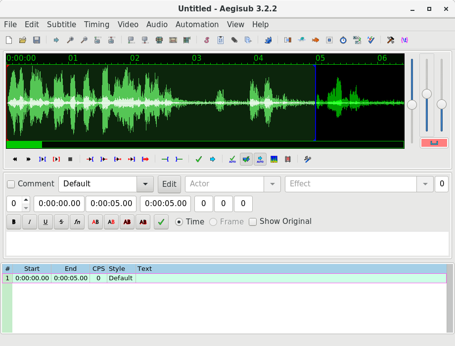

    The project’s main developer isn’t active anymore and is no longer maintaining the program. There is one fork that is still being developed whose maintainer you could report those issues to. That’s probably your best shot at getting this fixed. (You could also report this on his discord.)
  20. From your waveform is shown that the audio is too loud already, the slider controls on the right adjust that. What the program calls "Vertical Zoom" are actually volume controls, lowering that will solve your crackling problems. Learn to use the "Spectrum analyzer mode" for a more precise work.

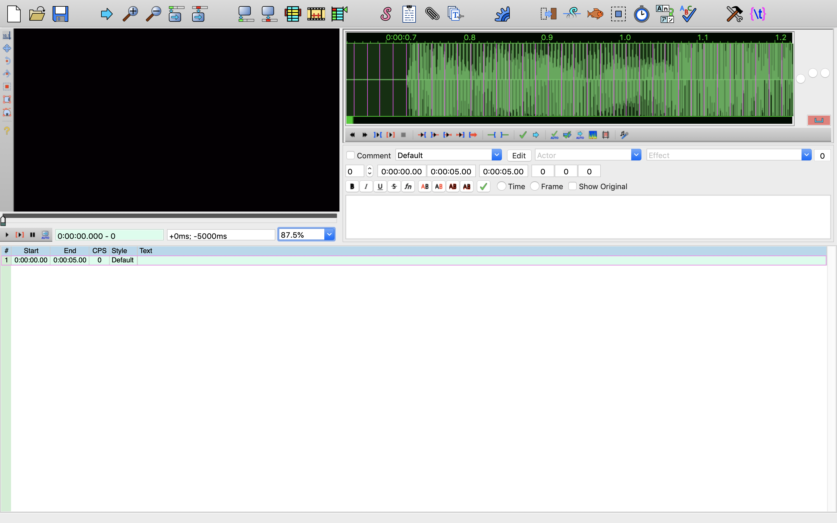

  21. Firstly, Thank you so much for the answers. I'm new to the forum and did not expect that anyone will reply. Thank you so much
    Anyway, I think i get more understand about my problem here. But the slider bar that you're talking about, It seems like I cannot adjust it. It's just a fixed button
    [Attachment 47986 - Click to enlarge]
    How can I adjust it?
