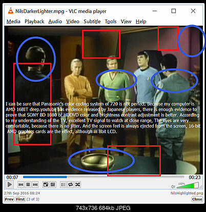

  24. Click image for larger version
    I can be sure that Panasonic's color coding system of 720 is not perfect. Because my computer is AMD 16BIT deep.youtube has evidence released by Japanese players, there is enough evidence to prove that SONY BD 1080 or HDDVD color and brightness contrast adjustment is better. According to my understanding of the TV, excellent TV signal to watch at close range, The eyes are very comfortable, because there is no jitter. And the screen feel is always ejected from the screen, 16-bit AMD graphics cards are the effect, although in 8bit LCD.
