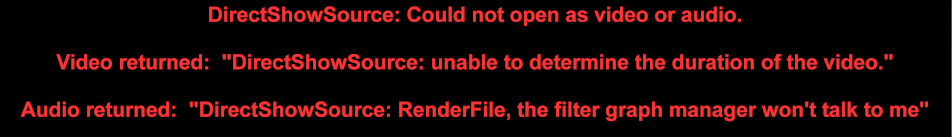

    The third path I took: Using DirectShowSource
    • I make a .avs file for my M2V video file with the code ‘DirectShowSource(“c:\videoname.m2v”)’.
    • I try to open it in WMP, and get this:
    [Attachment 45241 - Click to enlarge]
    • I try to instead open the AVI file I know opens with AviSource, changing the code to ‘DirectShowSource(“c:\ogvideoname.avi”)’, and the video opens in WMP just like it would with AviSource. Doesn’t solve my YV12 issue, but glad to know something works.
    • I try to open an MP4 file, once again for testing. WMP plays the first frame for the duration of the video. Adding to the code so it’s ‘(“c:\videoname.mp4”, fps=23.976)’ doesn’t fix this. Same thing happens with MPG.

    You probably have avisynth x86 installed, so WMP x64 will not work . You would need to use avisynth x64 to work with wmp x64 .

    Post the error messages verbatim. Don't summarize the messages because there are clues there that tell you exactly what the problems are

    Ah, I am using AviSynth x86, so that could very well be the issue.

  4. Install filter with support of YV12 - for example LAVfilter - strangely Windows may not support YV12 natively, generally it was issue with "YUV" - side to installation filter must be also associated correctly.

    I'm pretty sure all the error messages I described are word for word, other than the vdub issue I briefly mentioned, and that was mainly because once I got one error message I just went back to trying to fix the original issues and didn't try using vdub further. Are you saying I should post a screenshot instead of directly quoting it?
    vdub was the one I was referring to. A description of the problem and error message would have been helpful. vdub and avspmod are the most reliable, consistent ways to check and diagnose scripts. Whereas media players like WMP have other issues that can confuse the problem - there are other configurations and filters that can make identifying underlying issues more difficult

    i install Avisynth+ instead
    and with k-lite codec pack"Codec Tweak Tool" click "Prefered splitter" and use "lav splitter" for Avisynth, the avs script play fine to any media player after that

    Ah, ok. I'm pretty sure the issue was that vdub couldn't read V210 codec(Avisynth had this issue too), so today I simply exported the same clip using UYVY instead and it played fine. I'm mainly just wary of using VirtualDub because it's a whole other thing I'll have to research on how to use. The Lagarith codec video also played, so now I'll be looking up how to preview/run a script with vdub...
    Update: was able to get the script to run in vdub, and so far that seems about the same level of sharpening as I would get in Premiere. A little hard to tell, so I'll play around with it more later.
