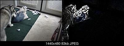

  2. That's how motion detection works. If abs(A - B) > threshold, where A is one picture B is the next, then there's motion.
    Here's an example where one of our dogs was caught red handed mangling her bed while nobody was home:
    On the left is the normal image. On the right is that frame subtracted from the previous frame, then the absolute value multiplied to make the differences more obvious. You can see that unmoving background is all black. The dog and cushion in motion show up as brighter areas.

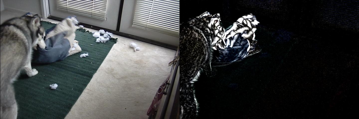

    [Attachment 45234 - Click to enlarge]
