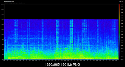

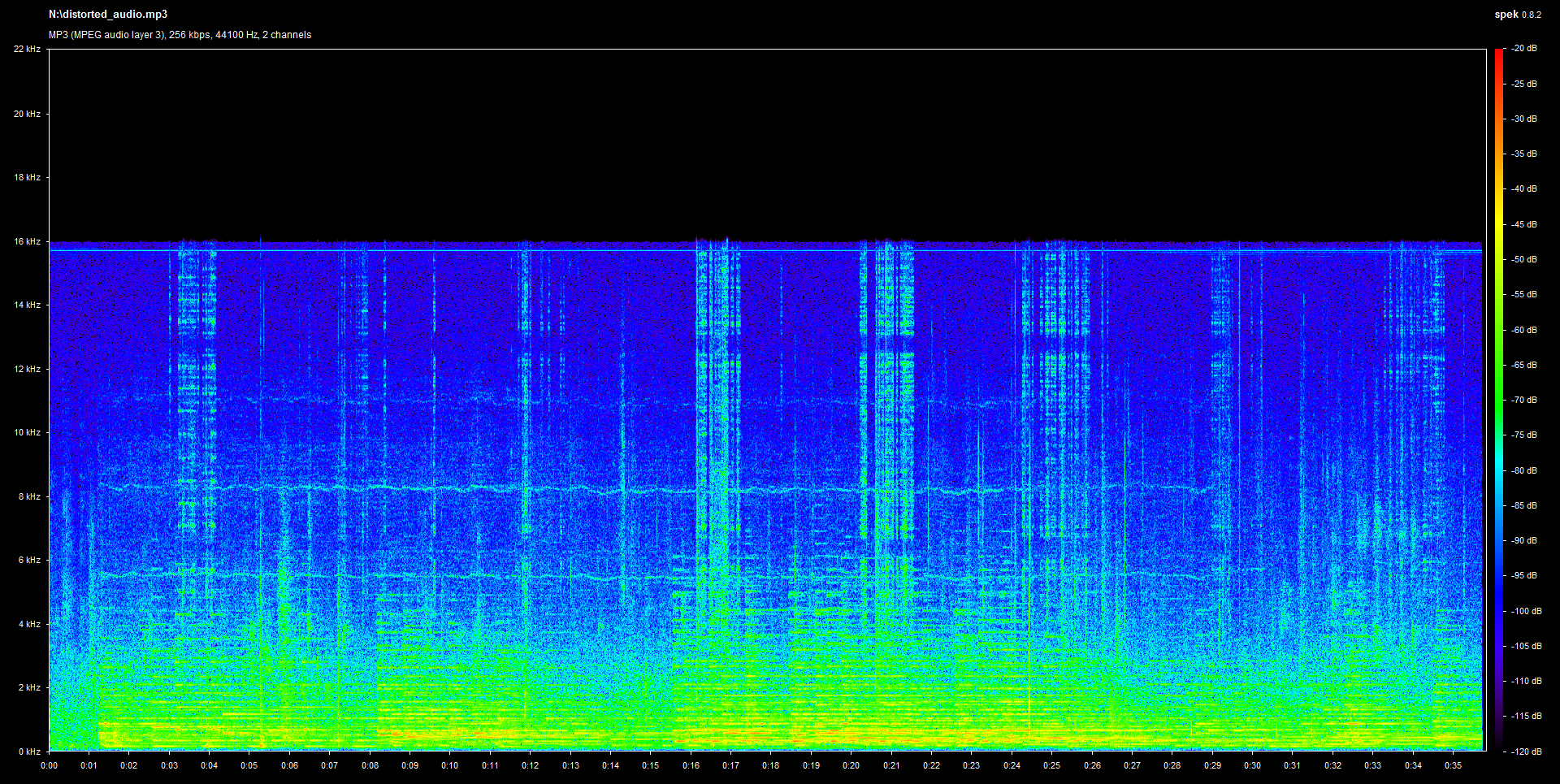

    Originally Posted by Hypersonic1 View Post
    MiniDV is supposed to be digital.
    Digital is just a medium. You still input analog signals, sample them digitally at a given interval and given accuracy (bit depth), and then upon playback it comes out analog again. Feed digital a garbage signal, and it will output a garbage signal.
