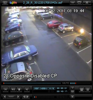

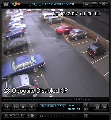

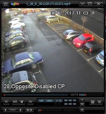

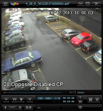

    decoded 2 of them... decoding last now. the ones I have decoded are 09:00:00 - 09:59:59 and 10:00:00 - 10:53:22. The 3rd just finished and shows 08:19:42 - 08:59:58. The original is 11:03:30 -11:03:31
    I did not see anything major but then I don't know where or what I should be. The quality is 574kbps bit rate and 352x288 so I wouldn't hope for plate information or faces for that matter. These are NOT reencoded by the way so what you see is what they were downloaded, I just trimmed unnecessary coding information and renamed. I will upload them to my web storage and let you know here when it is finished.

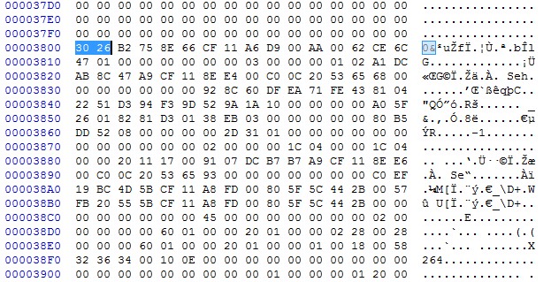

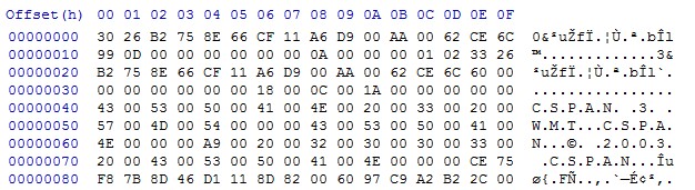

    To fix the ASF was actually easy since the format of the 'Container' is similar to the FLV 'Container'. It is usually Header-> Data (and maybe an index), similar to FLV. You can usually use a Hex editor (HxD) to cut off the extra junk or damage and at least get the rest of the video ok. In this case, You had a header (starts with hex '30 26' usually) but also had what I 'ASSUME' was an extra chunk of stuff, probably something to do with the capture software.
    EXTRA STUFF
    [Attachment 45242 - Click to enlarge]
    I simply cut off the extra so 30 26 were the first bytes and saved. A normal ASF is often just this simple:
    [Attachment 45243 - Click to enlarge]
