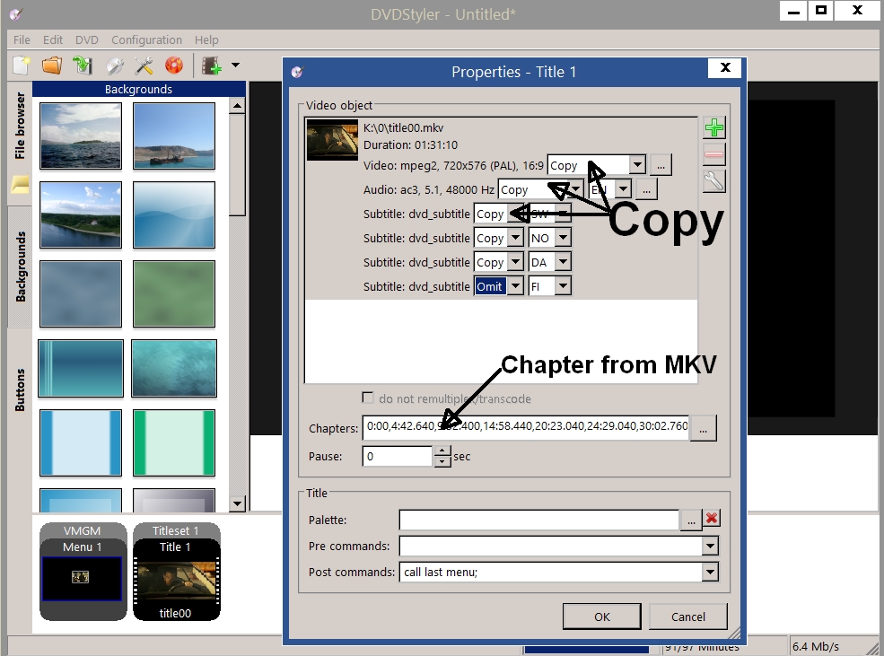

    One way could be to rip the DVD with MakeMKV. The chapter points from the DVD will be in the created MKV file(s).
    Use it in DVDStyler in a project without a template. It should automatically select "Copy" mode for video/audio, eg no re-encoding and use the chapter points from the MKV file. Create the menu(es) to your liking.
    [Attachment 45131 - Click to enlarge]

    Wouldn't the MKV itself be a re-encode?

    In avs2dvd you can demux the DVD and reimport the raw streams again. Makemkv doesn't re-encode, it just recapsulates the streams

    The mkv is a straight copy of the original mpeg2 put in a mkv container,no re-encoding done.
