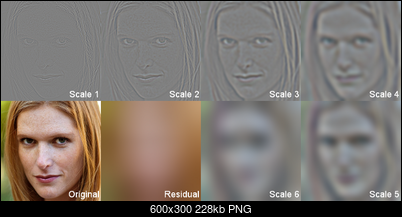

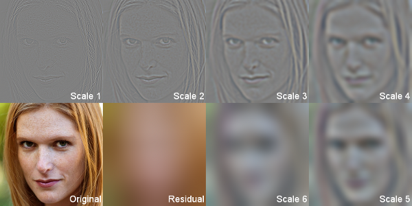

    Decomposition may look like this:
ID:	45135 So residual part in your case should be this one that is considered as noise (fluctuate over time) by temporal average you may stabilize and reduce such fluctuations (i think that this is periodical change so windowed averaging should help to isolate correct signal).
    More or less this is more like statistical processing and you may need special software (avisynth with plugins may be helpful but probably there is lot of work as it will be multistage operation).
