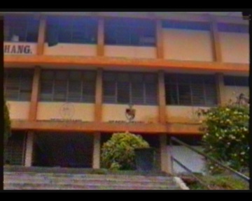

    Hi there, recently I started digitizing my parents Marriage tapes which were recorded on something else before transferred to VHS tapes. I've paid a local store to do the job but I think they did a poor job. Though admittedly the source was in poor condition as well. At least they were kind of enough to let me keep the original interlaced mpeg2.
    I've uploaded their footage to utube for reference: https://www.youtube.com/watch?v=K7qzI5QGwWo
    I was thinking of using QTGMC to deinterlace but then thought, might as well touch up the video where I can. To start off, does anyone know what kind of artifacts are present in this sample? There are lots of jagged lines and the color glitches. I hope someone can lead me in the right direction.
    Image Attached Images
  2. 1. Deinterlacing is just going to add to all your problems. Forget about that for now. It really is not needed for anything, and it certainly is not going to do anything to fix all the problems you have. In fact, because of #2 below, deinterlacing will just make things worse.
    2. The Sample.mp4 file is full of duplicate frames. It also has aspect ratio problems (the black bars at the top and bottom).
    3. Do you know anything at all about what equipment was used to originally take the video? Was it some sort of professional tape, like Beta SP (not to be confused with the consumer Sony Beta format, which was a rival to VHS)? You say it was "recorded on something else before being transferred to VHS." What was it recorded on?
    4. Do you know anything about the VHS tapes that you had the local store transfer? Were they, in fact, PAL format, or were they something else? I am trying to figure out why you are getting so many duplicate frames.
    5. Is the Sample.MP4 file something that you cut directly from what the transfer store gave you, or did YOU re-encode their video? If you did, then that will further degrade it and make it difficult for people in this forum to provide correct answers. You always need to do a lossless cut from the original video so that we know what you're working with.
    Neglecting all the problems already mentioned, the video is filled with what look like tracking and time base errors. Both can only be corrected by doing a better transfer. See if you can find another place to have the tape re-transferred.

    1. I only want to deinterlace so that I can upload it to YouTube for my overseas relatives. I would also upscale it so it won't be totally butchered by YouTube's low bitrate compression.
    3. Sadly no, my parents are tech-illiterates and the person filming was my uncle, who died long ago from cancer. Though I presume it was probably something cheap, as my mom said it looked pretty bad even back then.
    4. It has be to PAL, I live in South-East Asia.
    The shop owner told me the duplicate frames were due to the condition of my tapes. It was very moldy and I remember playing with the tapes when I was still a kid. So it was in very bad condition
    5. I exported the sample from Sony Vegas, my bad. Would Mpg2Cut2 be suitable for lossless cuts?
    I'm afraid VHS recovery is not easy to find here. This is the only store I can find that still does it, most others have already closed down. I would have to travel to another state for another store.

  7. I use Vegas every day, and have for over fifteen years. You need to match your rendering settings to the original clip size and aspect ratio. That is why you had those black bars. When you see black bars that are not in the original, you have done something wrong, and you are throwing away precious resolution, something you don't have to spare when dealing with VHS video.
    This sample looks much, much better, so quite a few of the problems in that original sample came from what you did in Vegas.
    Except for the duplicate frames and the obvious tracking problem, this looks like pretty decent VHS footage. You can adjust the gamma (contrast and histogram end points) in Vegas using Levels and/or Color Curves. This will help "punch it up" a little by providing a little more contrast. Don't do too much, or you'll lose detail. Use the Vegas Videoscop, set to the Waveform display, to help you get the correct contrast levels.
    You can get rid of the single-frame duplicates by using the FilldropsI() AVISynth function I created years ago. You'll have to use AVISynth, and if you don't yet know how to do that, it is beyond what I can do in a single forum post to teach you. Here is that function, however, in case you do know AVISynth or want to try:

    This works extremely well and, in most cases, you won't be able to detect the synthesized frame that is inserted for the second duplicate.
    There is, of course, absolutely nothing you can do about the tearing along the top, unless the camera is on a tripod and not moving. In that case you can create a duplicate track in Vegas; on the lower of the two tracks find a frame where the top of the frame is OK (no tearing), and repeat that frame over and over again; and then use the mask function (in the pan/crop box in Vegas) on the video in the top track to let the bottom track show through. As long as there is not too much motion happening at the top of the frame (which is pretty typical of a lot of video) this trick will work.
  8. Here is a link to a version of your clip with he single-frame dups removed (nothing can be done about the 1/2 second freeze). I also changed the gamma to make it a little punchier and did very light denoising with MDegrain2. A little sharpening might bring out a little more apparent (not real) detail.
    Slightly Improved Version
    I did look at the video by separating it out into individual fields, and some of the glitches are only in one field. It might be possible to bob the video; detect glitches that only happen in one field, but not the other; use filldrops (the progressive version) to create a new field from the surrounding ones; and then put everything back to interlaced. That would not be easy, however, and won't help with the tracking noise at the top of the frame.
    The way to deal with the tracking is to get your own VHS desk and switch it to manual tracking. Take the sections which have bad glitches and then "tune" the tracking control until the top of the frame (where the problems happen) looks OK. Ignore any new noise that starts to show up at the bottom of the frame. Capture that, even if the rest of the frame looks bad. Then, line up the original capture and the new capture and use the masking feature in Vegas to combine the top part of your new capture with the bottom part of the old capture.
  9. Some sharpening too:

  16. I just looked at the sample you uploaded. Unlike the previous sample, this one has massive numbers of drops so that you don't have even 1/2 second of continuous video before another extended drop happens. I have no idea how to fix this, and I suspect it cannot be fixed.
    If you still have the tapes, the ONLY solution is to have them re-transferred. Whoever did it used a technology that was unable to encode frames as they were losing sync. I do not have knowledge of all the capture cards and technologies that are used, but if you transfer using old-fashioned DV technology, it can capture pretty much anything. Using a VCR with a time base corrector (TBC) might help stabilize some of the timing signals that are causing the capture card to lose sync.
    Finally, some VCRs have a menu option to put out a blue screen whenever the video is beginning to tear or corrupt or go to snow. You want to turn that off. As bad as video glitches can be, with AVISynth, you can often do something with corrupted video frames, as long as there is something there. Once it is 100% gone, you end up with what you have.
    So, the "solution" is to get a new transfer.

    I'm not seeing any back-and-forth movement with QTGMC().
    Mpeg2Source("Clip.d2v", Info=3)
    QTGMC()
    Back-and-forth motion indicates the wrong field order. Your video is top field first (TFF). Mpeg2Source() should set the field order flag. If it doesn't specify it yourself with AssumeTFF() right before calling QTGMC(). Some filters can change the field order (cropping an odd number of lines off the top of the frame, for example). So watch for that.

  29. Add SelectEven() after QTGMC. That will reduce the frame rate to 25p, and you'll still have duplicate frames, but the back-and-forth movement will be gone. I'll write more later, when I have time.
  30. Regarding the back-and-forth motion after QTGMC:
    Each frame of interlaced video contains two separate half-pictures (called fields) taken at two different times. The two images are intended to be seen separately and sequentially. So you're 29.97 fps interlaced video is supposed to be displayed as 59.94 fields per second. So with each frame indicated by two numbered fields in parenthesis, a video like:
    (0,1) (2,3) (4,5) (6,7)...
    the fields are displayed one at a time as:
    0, 1, 2, 3, 4, 5, 6, 7...
    But your video has may duplicate frames from a problem during capture:
    (0,1) (2,3) (2,3) (2,3) (2,3) (2,3) (4,5) (4,5) (4,5) (4,5) (4,5) (4,5) (6,7)...
    Frame (2,3) appears five times, frame (4,5) appears six times. So what you see at playback (or after QTGMC) is:
    0, 1, 2, 3, 2, 3, 2, 3, 2, 3, 2, 3, 4, 5, 4, 5, 4, 5, 4, 5, 4, 5, 4, 5, 6, 7
    All that alternating back and forth between 2 and 3, and 4 and 5, is responsible for the back and forth movement. At 59.94 frames per second it looks very jittery. And, of course, all those repeat frames appear instead of the frames that should have been there, making motion very jerky overall.
    Using SelectEven() after QTGMC() discards every other frame. So you're left with a:
    0, 2, 2, 2, 2, 2, 4, 4, 4, 4, 4, 4, 6...
    That gets rid of the back-and-forth movement. But at the cost of less smooth motion in parts of the video that don't have duplicate frames. And, of course, all the duplicates frames are there instead of the frames that were lost during capture, so motion is still jerky.
    The only practical solution for this video is to re-capture the tape with better equipment, thereby avoiding the missing and duplicate frames.
