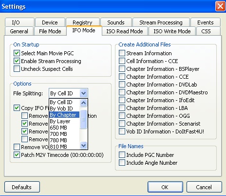

    DEEP in the settings is an option "By Chapter".....it will give you ALL of the chapters on the DVD at one time.
    I don't even know how to get DVDDecrypter to take one chapter at a time.
  8. Member hech54's Avatar
    Jul 2001
    Yank in Europe
    Screenshot:
  9. Top man, thank you, I'll give that a go. Cheers!

    Not at all. hech54 showed how to get all the chapters at once. I expect that at least the longer titles will consist of more than a single chapter. If so, you might also investigate "By Vob ID" to see if that gets you all the different and complete shorts and films. Since you discovered IFO Mode, if you're not being shown a bunch of different titles then they must be all in a single title (very poor way of doing it). And for the longer titles, anyway, the ones consisting of multiple chapters, you can rejoin them into a single complete video using MPEG2Cut2, if it comes to that.

  11. By VOB ID worked like a charm, thanks manono. Long delay because I realised the cause of intermittent DVD Decrypter hangs was that my hard drive was on its last legs. Got a new 3TB beast and subsequently will be giving L&H a few more percentage points of encoding quality to celebrate. Cheers all!
