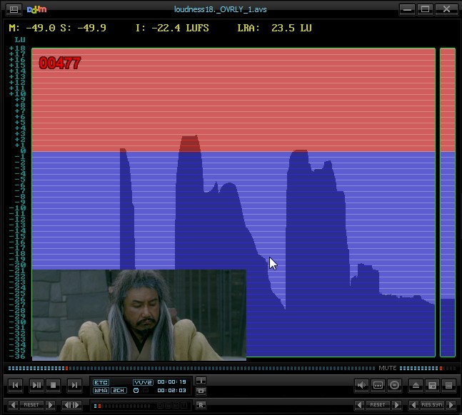

    Would something like this work using EBU r128 as RaffRiff42 suggested and the output overlay-ed by the actual video? Frame by Frame is displayed at the top as well as the frame number. This corresponds to the Bar graph at the right with representaion showing later in the Larger bar graph area.
    [Attachment 45105 - Click to enlarge]
