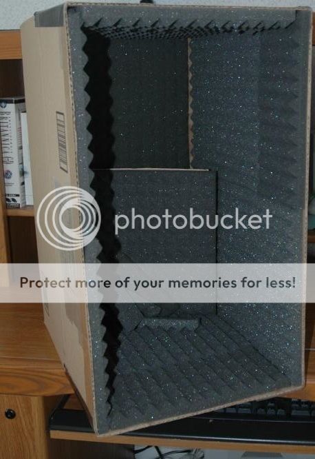

Without a sound sample, it's tough to know if you are experiencing an echo caused by electronic loops in the mixer, or whether it is room acoustics. Since DeJay mentioned the foam box, here is what I built, based on the ideas from Douglas Spotted-Eagle, which he posted over a decade ago. You put the microphone in the center of the box (back where you see some of the leftover foam in the picture), and add your pop filter (I use a Stedman Proscreen PS101). You still need to get close to the mic -- there is absolutely no substitute for that -- but the box will cut out virtually all the reflections from the room. The result is voice quality that rivals what you can do in a proper DJ booth. I built mine out of nothing more than a cardboard box and some acoustic foam.
The only problem is that, if you are trying to play a game at the same time, this box will probably get in the way. However, you won't get any echo. -
