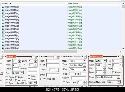

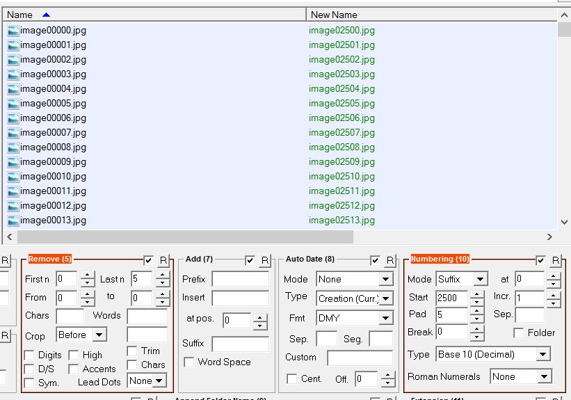

  5. This is how easy it is. This is the one I use, but there are others like it
    http://www.bulkrenameutility.co.uk/Main_Intro.php
    1) Export the remainder of the aborted sequence as normal into a different folder. It will start with "image00000.jpg" (or whatever name)
    2) In the program, navigate to the folder, you can press ctrl+a to select all
    3) In the remove box, you want "last n" set to "5" in this example ( so image00000.jpg becomes image.jpg) . You can see it "live" in the preview in green text
    4) In the numbering box, mode suffix, start 2500, pad 5 (because 5 place holder digits)
    5) Push rename (not shown in the cropped screenshot)
Name:	bulk rename utility.jpg
