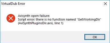

    Here's my problem.
    When i create the .d2v file within DGindex and then try to put it into Virtualdub i get this error message.
    [Attachment 45043 - Click to enlarge]

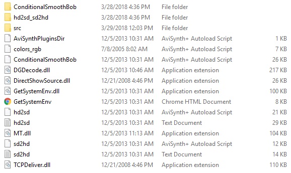

    with all the necessary plugins i have within my Avisynth plugin folder (pic below)
    [Attachment 45045 - Click to enlarge]
    I have been through so many forums and tutorials over a week now trying to find a solution to this problem and the only one i can find says to input the plugin GetSystemEnv.dll and that should fix the "GetWorkingDir" error, unfortunately i still keep getting the error.

  2. What happens with a simple:
    #SetMTMode(2,0)
    MPEG2Source("Awards.d2v")
    #hd2sd(interlaced=false,OutputColorspace=YUY2,Wide screenType=0)
    You probably don't want your output colorspace to be YUY2. Your source is YV12 (isn't it?) and so is the final output. But maybe you have your reasons. Also, most - if not all - of what you're doing in Adobe can be done more easily, faster, and with better resulting quality in AviSynth. Not the encoding, of course.
    I've never in my life seen that error message so I don't know what that's about. Must be something to do with hd2sd. And you can downscale without using that also. And why two resizings and two MPEG-2 encodes?

    hd2sd (interlaced=false) is wrong too, if you actually have interlaced content as you reported you had 1920x1080 60i . This tells the script you have progressive content
    This looks like the old hd2sd package. "MT.dll" is an older implementation as well . It should still work, but some of the workflow is a bit outdated. The main issues with letting NLE's do this, was the interlaced scaling. They do a poor job. But if you bob deinterlaced (to 59.94p) and used progressive scaling, most of the issues go away. That hd2sd script also does other things like change colors to rec601 (for SD) .

    In your plugins screenshot, there are missing extensions. For example, AviSynthPluginsDir should have an .avsi extension to autoload. There is none in your screenshot. Same with ConditionalSmoothBob and colors_rgb . But you have extensions enabled in windows explorer view mode because I can see some .dll' s
