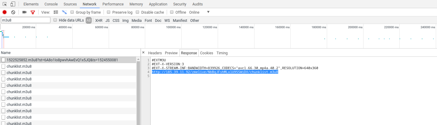

use the broser inspector and check network for m3u8 file
[Attachment 45340 - Click to enlarge]
then play with streamlink
streamlink --http-header Referer=http://www.realtimetv.me 'hls://http://185.39.11.92/zmelive/NbBqJFshMLxlU95SWiDX/chunklist.m3u8' best
