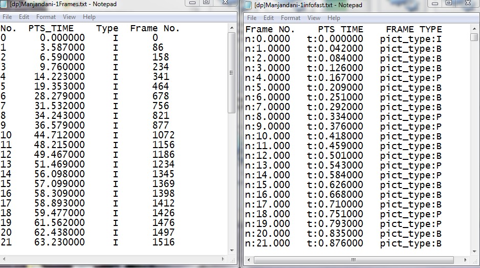

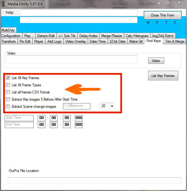

    I'm not sure what you exactly want but I may be able to help and you can may be able to help me. I am writing in Visual Basic and .Net and if more info is needed it can easily be added. Do you know C++ language? If not, why does it need to be in C++? If you do, just call the FFMPEGg/FFPROBE programs suggested above and then parse the fields from the resulting files. You will get lists as shown below. Do you need more information on the frames?
    [Attachment 45022 - Click to enlarge]
    [Attachment 45023 - Click to enlarge]
