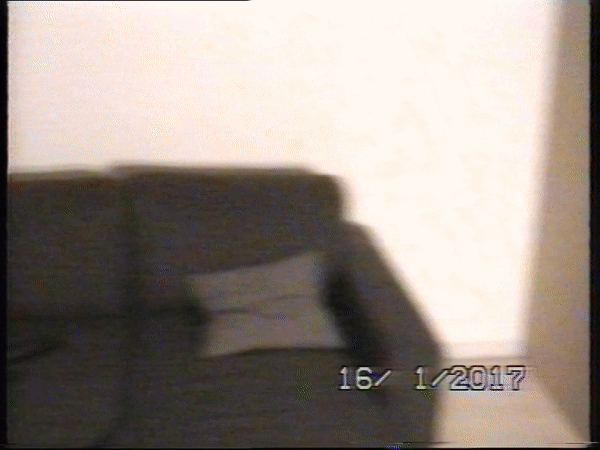

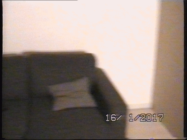

I got a Sony EV-T2 which I'll be using to capture our old Video8/Hi8 videotapes and some VHS tapes.
However, my 'good' capture card, the Hauppauge USB-Live2 has some odd way of handling unstable input, compared to my inferior Dazzle DVC100
Which is an example of what I see A LOT of when there's unstable input:
Where-as the Dazzle handles it way better: https://forum.videohelp.com/images/imgfiles/hKIHjBb.gif
The VCR has a built-in TBC and I've got no money for an external one, those things really seem too pricey for me, so I was wondering if I could use the Panasonic ES-10 as passthrough to fix these issues? It just so happens a guy is selling one of em in my town.
