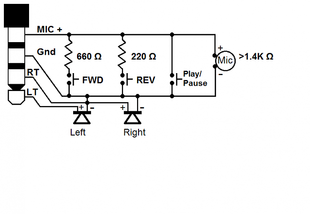

  6. It appears the Android 3.5mm jack applies a voltage across the mic, to power it and also certain control switches:
    https://forums.androidcentral.com/samsung-galaxy-s4/334540-galaxy-s4-headset-mic-butto...ic-pinout.html
    [Attachment 44969 - Click to enlarge]
    Your manual is telling you then, not to use the battery when it's not needed.

    Makes sense. Thx!
