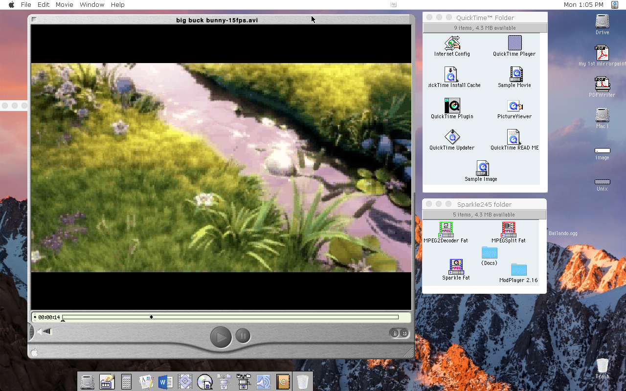

  6. Image
    [Attachment 44966 - Click to enlarge]
    Your encoded samples worked well!
    Both of them ran with audio and video. The 15 fps sample played much better on my emulated Mac whereas the 24 fps sample was very choppy. Thank you for encoding those Danny, now we all know a working solution to Cinepak encoding for 68k Macs
