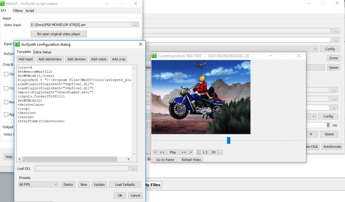

  13. Lone soldier Cauptain's Avatar
    Jan 2006
    Brazil
    Hi SimplyDex,
    Do u install all dependecies? Put in correct paths?
    Use this:
    Cores=4
    SetMemoryMax(512)
    SetMTMode(3,Cores)
    PluginPath = "C:\Program Files\MeGUI\tools\avisynth_plugin\"
    LoadPlugin(PluginPath+"svpflow1.dll")
    LoadPlugin(PluginPath+"svpflow2.dll")
    Import(PluginPath+"InterFrame2.avsi")
    LoadPlugin("C:\Program Files\Megui\tools\lsmash\LSMASHSource.dll")
    LWLibavVideoSource("your file.extensioni").ConvertToYV12()
    SetMTMode(2)
    InterFrame(Cores=Cores)
    I'm try now and no give any error.
    Claudio
