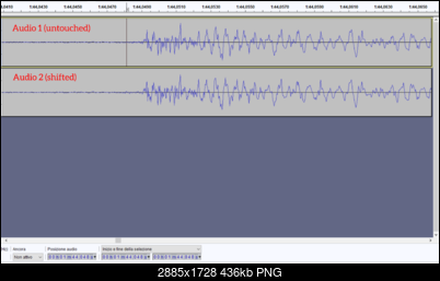

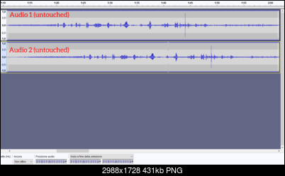

    This is how the two central channels look like in Audacity:

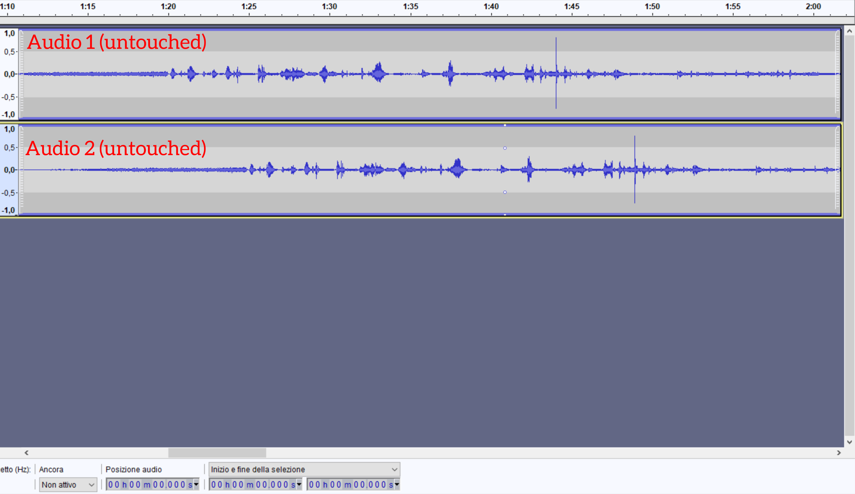

    I shifted Audio 2 so that it was in sync with Audio 1:

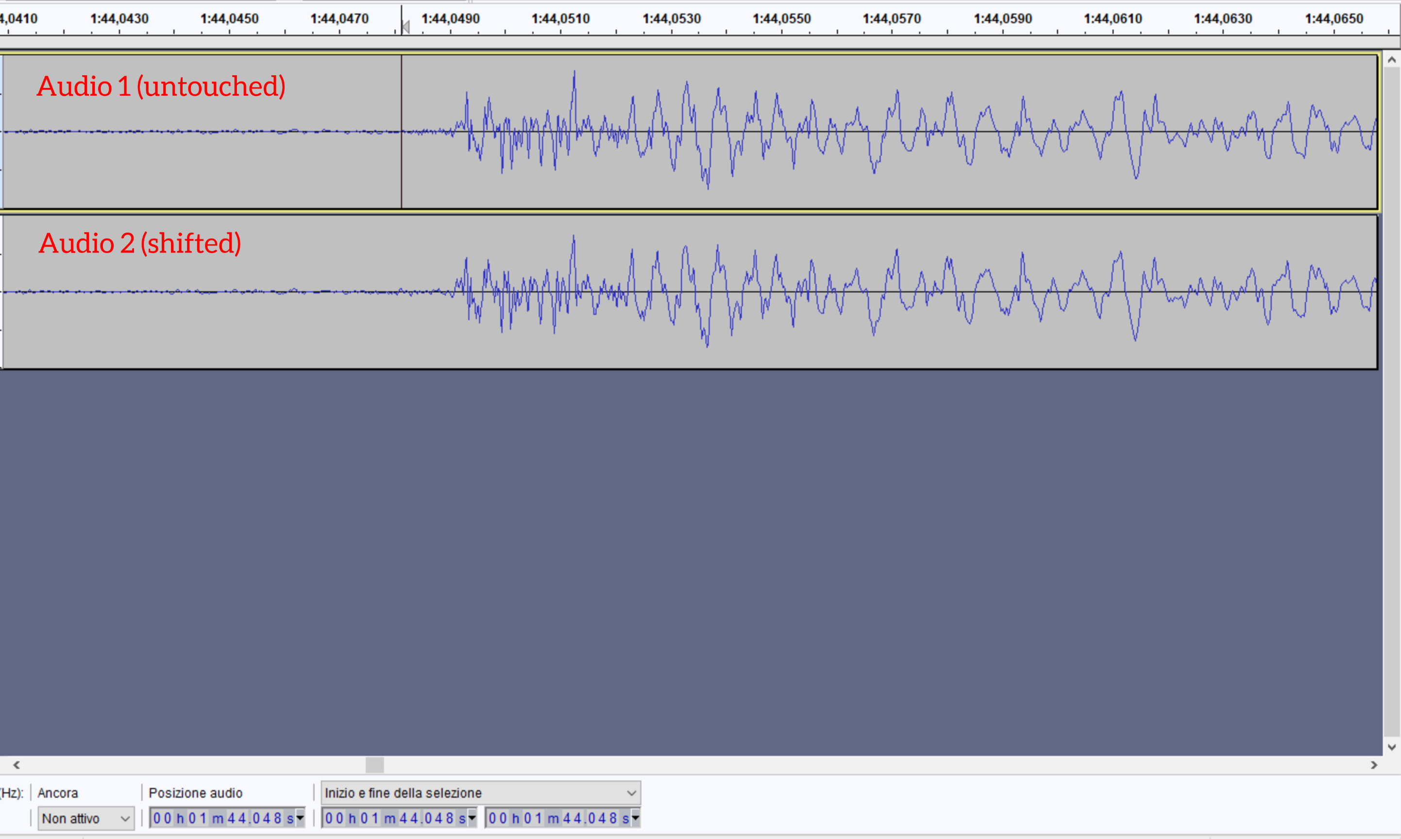

    By doing this I found out that Audio 2 was 4881 ms out of sync. I opened Audio 2 with MKVToolNix and wrote -4881 in "Delay", but for some reason the result isn't perfect: as you can see in the picture below, the two audio files are still out of sync by 12 ms.
    I then reopened the shifted Audio 2 with MKVToolNix and entered -12 but that changed nothing: the result was identical to the input. What am I doing wrong?
