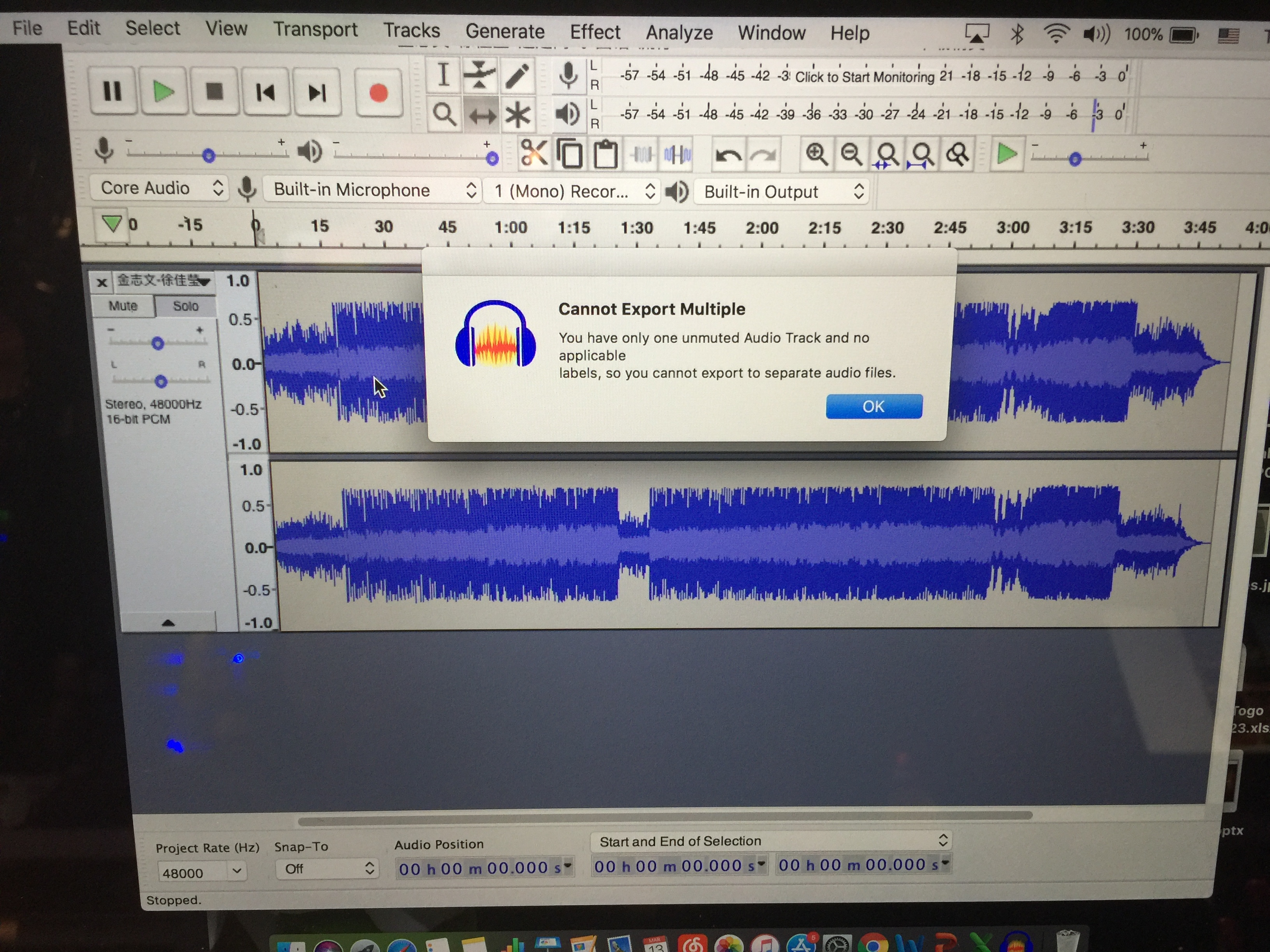

  8. Image
    [Attachment 44920 - Click to enlarge]
    Open your stereo audio track in a editor like Audacity. Split it into two mono tracks. Export the two tracks. Mux them with the original video with a tool like Imago MPEG muxer.
    Please help, what should I do now?
  9. You must split i.e. convert stereo audio track to two independent mono tracks - if split option is not available explicitly you may try to select Left channel and copy it to new mono audio track, repeat same for Right channel. Save such mono as independent tracks.
  10. Originally Posted by pandy View Post
    I see. After splitting into two Mono audio tracks. Both tracks still have the vocals when i play. I tried to mute one of them and switched around too. Still the same.
