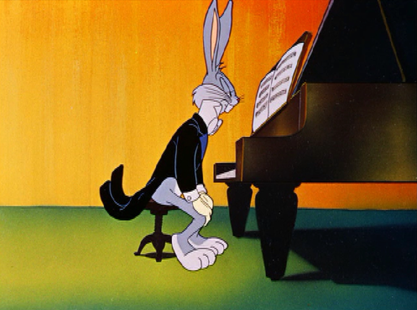

    I ripped my collection of Looney Tunes Golden Collection DVD’s using MakeMKV for use with my Plex media server. For some odd reason, when these videos are played via Plex or any other PC media player, jagged lines are visible on the edges of moving objects. At first I though perhaps this was related to an interlacing issue, however after closer examination this appears to be something different. The really odd part is that if I burn these clips back to DVD and play them on my STB DVD player, they look perfect with no hint of these jagged lines. Is my DVD player doing some kind of post processing which my PC isn’t? I’ve included a screenshot below.
    Any help is appreciated.
    [Attachment 44896 - Click to enlarge]
  2. It looks like it's being deinterlaced instead of IVTCed (inverse telecine) . Those jaggies are likely deinterlacing artifacts
  3. Yes, the video is encoded interlaced on the disc. Remuxing it into an MKV leaves it interlaced. The jaggies are from poor deinterlacing at playback. Try using VLC with deinterlacing set to Yadif 2x.

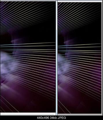

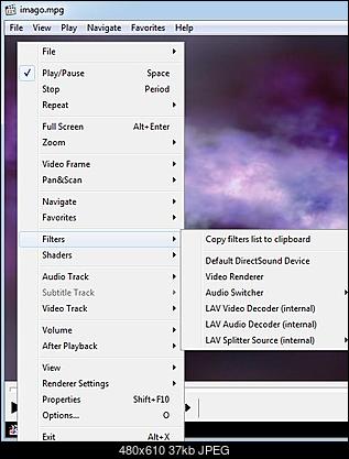

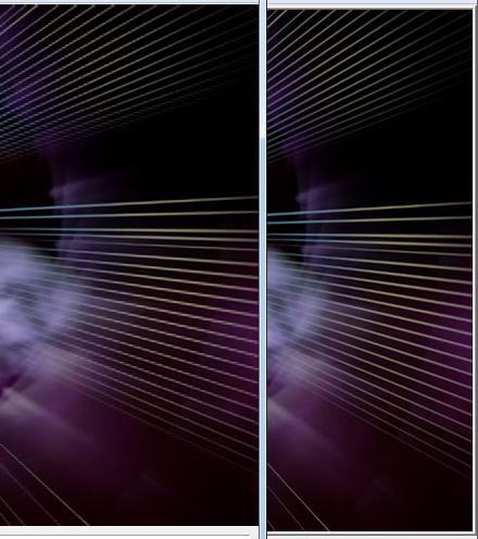

  20. No. Right click on the video while it's playing and select Filters -> Video Renderer (the name may vary depending on what renderer is in use.
    Here's a cropped sample where it's obvious MPCHC is deinterlacing (left) and the same frame displayed by VirtualDub on the right.

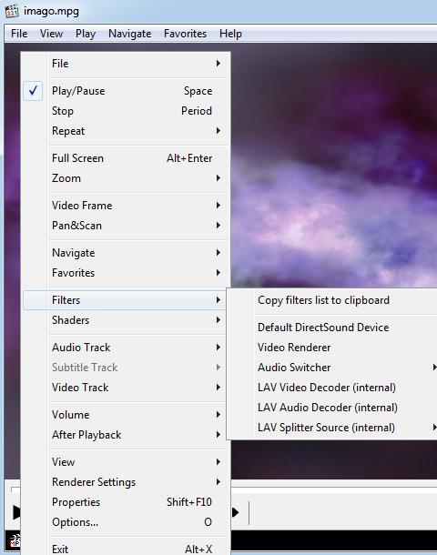

  21. I don't see that. Checking them I find a couple giving the framerate and it's not 47.xxx but 23.xxx.
  22. It may be the different decoders or renderers. Or some other settings.
    But that was my original point. What you see will depend on the software/hardware you are using. I don't use Plex so I don't know how it handles such video.

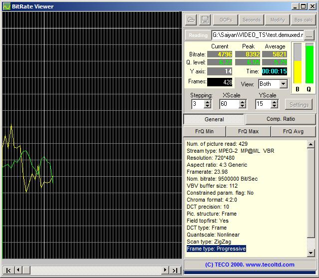

  23. Yeah, sure, but the video is progressive. If you follow the process I described and use a soft telecined DVD as a source, you get a fully progressive video, where you said it shows as interlaced. My MediaInfo posting earlier showed scan type as progressive. So does about any other app I use to have a look. And, if it's progressive, nothing should be either deinterlacing it or bobbing it. So, I don't understand.
Name:	BitRate Viewer.jpg
