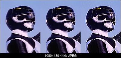

  2. The sharpness control varies on different devices. On some it may range from blur to sharpen with neutral in the middle. With others it may range from no sharpening to full sharpening with neutral at the former. Analog sharpeners are very crude and create over-sharpening halos -- so they should be left at neutral when capturing.

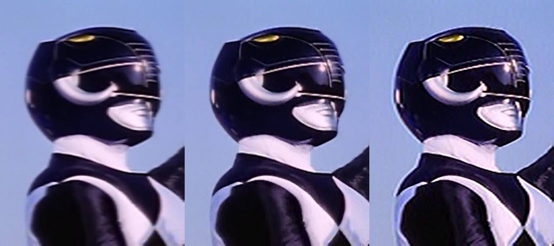

    Find a shot clip with a sharp, high contrast vertical line or edge and capture it at several different sharpness settings. Use the setting that delivers the sharpest picture without a halo.
    On the left the image is too blurry. In the middle the image is sharp but without halos. On the right the video is oversharp and has severe halos to the left and right of all high contrast vertical edges. Be sure to view the image full size by clicking on it a few times.
  3. When doing any transfer from analog video tapes, you want to defeat ALL sharpening circuits. On VHS decks there is often a control or menu item labeled "edit." When it is OFF (which is usually the default), the image is sharpened, but when it is ON (meaning you want to transfer the video to another deck or to the computer), the sharpening is turned off. So, you want Edit ON and Sharpening OFF.
    The problem with any sharpening done in the camera or in the video deck is that it is totally primitive and is usually nothing more than a peaking capacitor that adds overshoot when there is a really sharp transition from light to dark. This has the effect of adding a little halo which, even in the small version of the sample you provided is quite evident on the right-hand picture. That halo obscures actual detail but, to some eyes, make the picture more pleasing to watch. The problem is, once that detail has been obscured by the halo, you never get it back again ... ever.
    So, turn off all sharpening and then, if you want to add some later on, use one of the dozens of infinitely more sophisticated (and better) tools in AVISynth.
