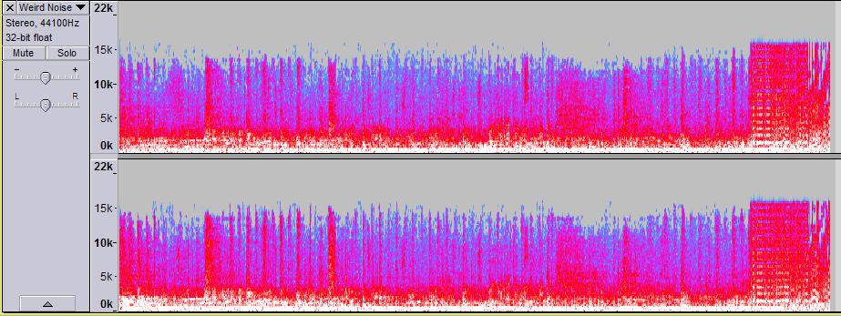

  11. Originally Posted by LifeDream777 View Post
    Is there any program that could scan the audio track of a file to detect this soundwave or any distortion...
    You can look at a spectrogram view of the audio. The problem area stands out very clearly:
    [Attachment 44904 - Click to enlarge]
    Thank you!! What program is this?
  13. Originally Posted by LifeDream777 View Post
    I used Audacity (with the ffmpeg source plugin). You can also use Spek. Most audio editors will have a spectogram view.
    Ok Thank you! I found it! Thank you so much!
