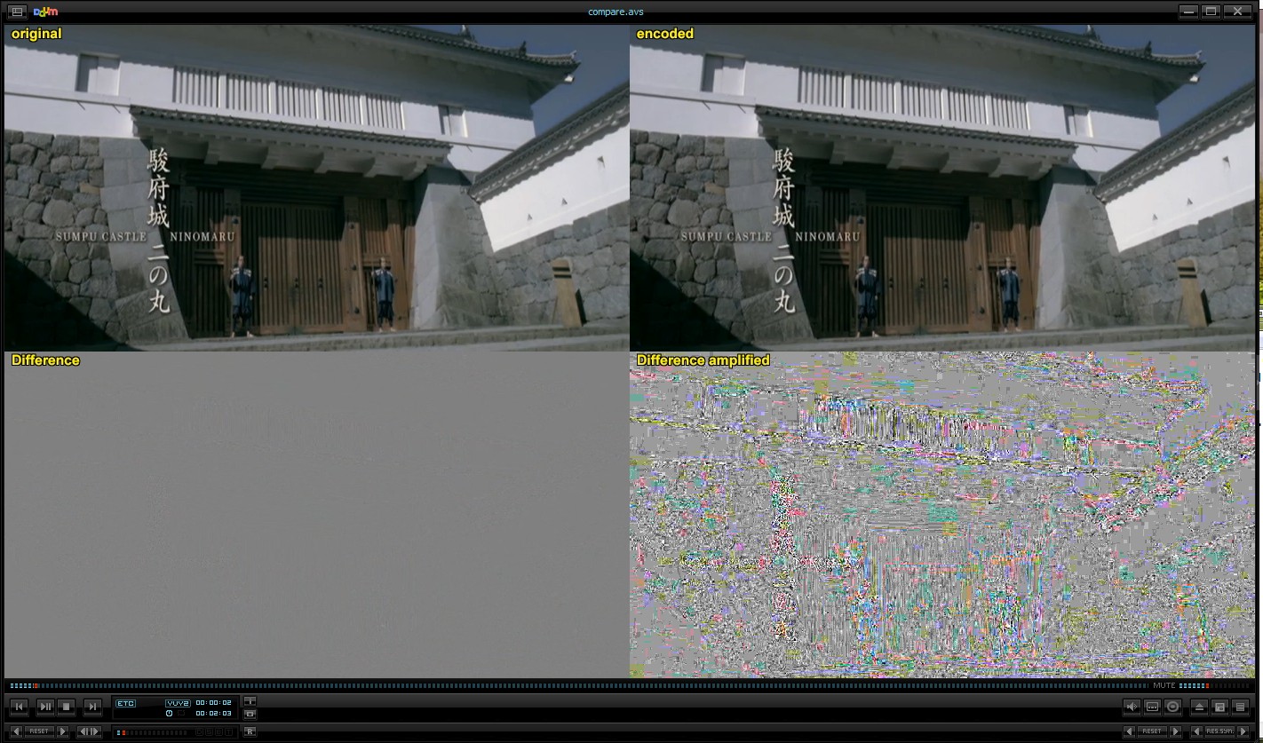

For an even greater visual check to add to Jagabo's script you can use a 'Quadrophonic?' scrip[t for more detail.
And then inspect the video as it plays:Code:v1=directshowsource("C:\PathToVideo\[dp]Manjandani-1.mp4", audio=false).ConvertToYV12() v2=directshowsource("C:\PathToVideo\[dp]Manjandani-1_2.mp4", audio=false).ConvertToYV12() sub = v1.subtract(v2) substrong = sub.levels (122,1,132,0,255) StackVertical (StackHorizontal (v1.subtitle ("original"),v2.subtitle("encoded")), StackHorizontal(sub.subtitle("Difference"),substrong.subtitle("Difference amplified")))
[Attachment 44876 - Click to enlarge]
