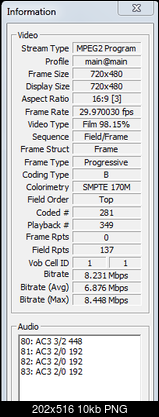

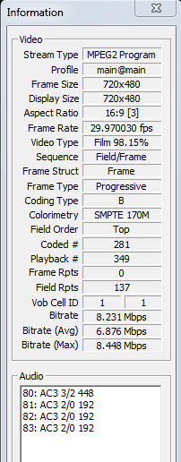

  30. Containers can flag frame rates that override the frame rate data in the video stream. I suspect your title is a mix hard and soft telecine, and MakeMKV flagged the soft telecine as 23.976 fps and hard telecine as 29.97 fps -- so the average comes out somewhere in between. Since the average is much closer to 23.976 the MKV file is mostly soft telecine and the short clip you posted just happened to from one of those sections.
    Try this: demux the MPEG 2 video from the MKV file then open it in DgIndex and Play it (File -> Play). Does it report just "Film" as the Video Type? Or something less than 100 percent Film?
