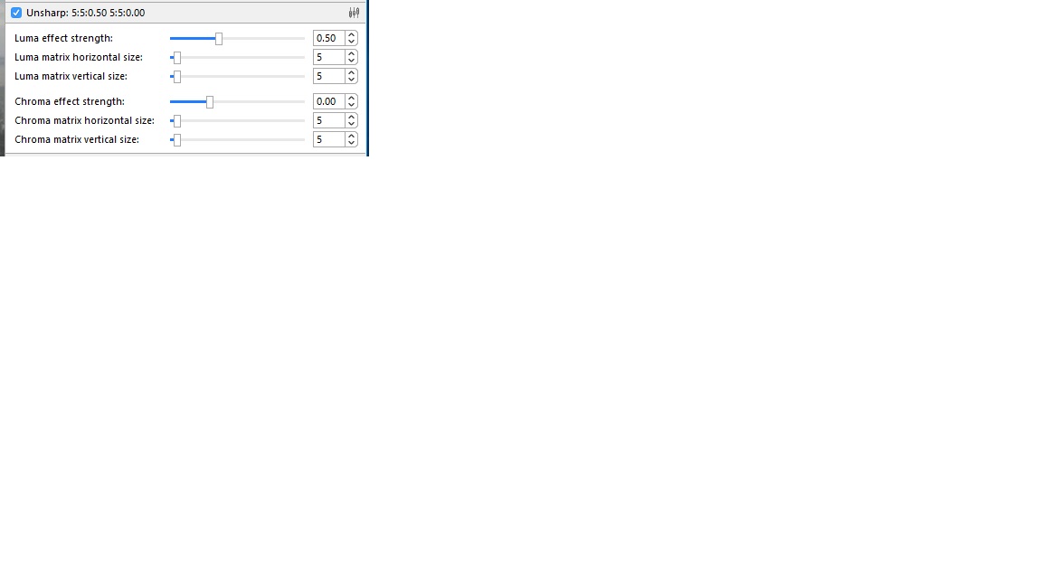

    I wanted to know if it's possible to load the "unsharp" filter from Xvid4PSP 7.0 on Avisynth?
    I like this sharpening filter (luma effect strength sharpening) and I want to know if it's possible to load it elsewhere.
    thank you

  6. I think it's a ffmpeg filter . The parameters match the screenshot above for xvid4psp
    https://ffmpeg.org/ffmpeg-filters.html#unsharp-1
    https://github.com/FFmpeg/FFmpeg/blob/master/libavfilter/unsharp.h
    I don't think there is a direct avisynth port from the ffmpeg filter . But you can probably get similar results using other filters

  16. Originally Posted by david.dgc View Post
    Do you have any clues how to tweak only the luma sharpening?
    Using Unsharp?
    Unsharp(Strength=0.7,Y=3, U=2, V=2)
