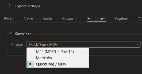

  14. I need to upload my footage to a website that only accepts MOV files.
    I installed the Voukoder plugin. But when I want to export it and select Voukoder, it still saves as MP4. I don't see the MOV option anywhere..
  15. Originally Posted by MelleBax View Post
    in the export settings, multiplexer tab, select mov from the dropdown menu
    [Attachment 44855 - Click to enlarge]
    Also, you'll probably want to set a lower CRF value. I think default is "23" . Lower values yield higher quality, larger file sizes. Maybe around 16-20 for general use is a good starting point

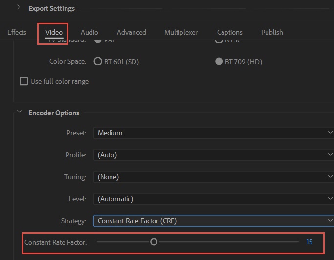

  18. The lower you set the CRF value the higher the bitrate will be (unless there's some other constraint in the settings).
  19. In the export settings, video tab, go to the constant rate factor slider . Lower values yield larger files, higher quality. For general use 16-20 might be a good starting point. If you want higher quality , maybe try 10-15
    [Attachment 44858 - Click to enlarge]
  20. Many thanks to you all for the help! I really appreciate it
    I did manage to get a higher bitrate (even higher than the original footage) with about 18 CRF. Great!
