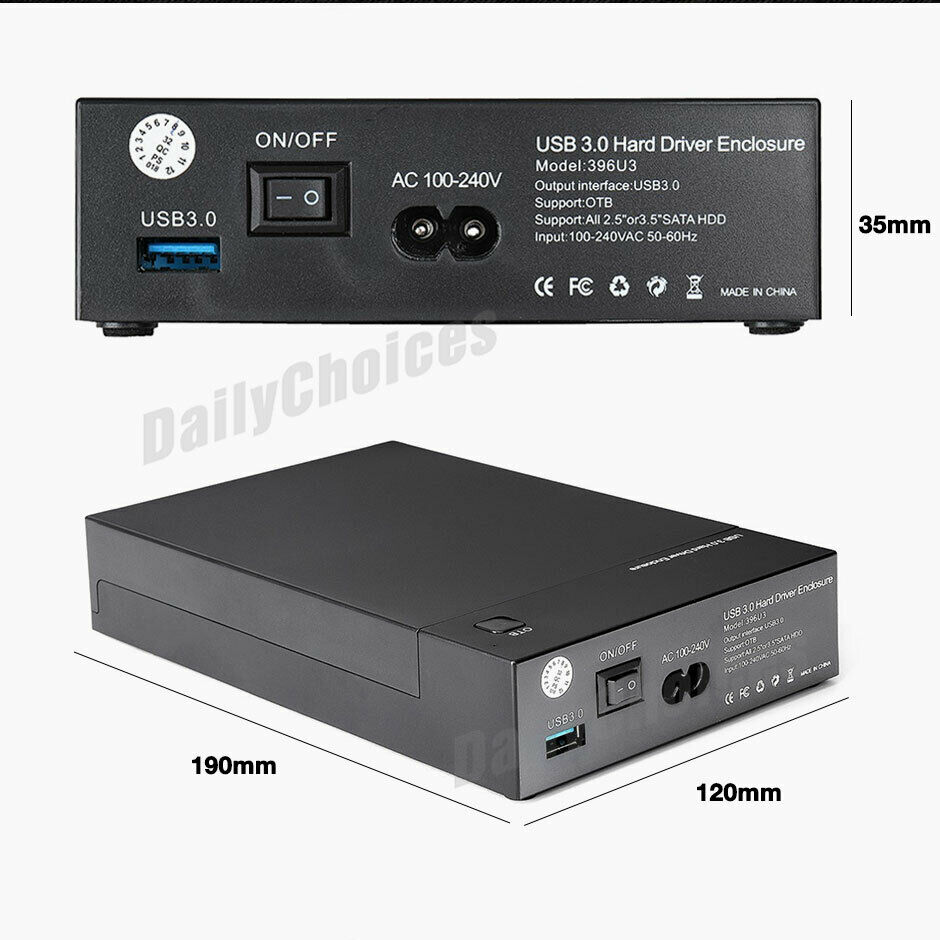

    Hey Rick
    will something like this work
    2.5/3.5 inch SATA External USB 3.0 Hard Drive Enclosure Caddy Case HDD Disk or this
    [Attachment 57388 - Click to enlarge]
    [Attachment 57389 - Click to enlarge]
    these are looking fine. as long as it convert the SATA to USB and it has a power cord (not sata power).
    the last one looks fine. how much it cost?
