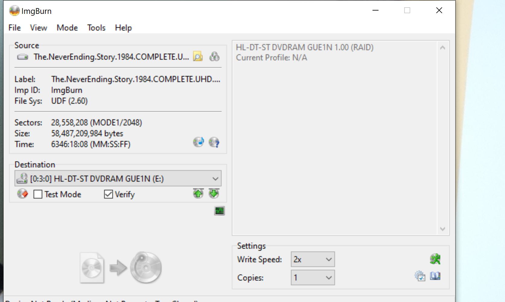

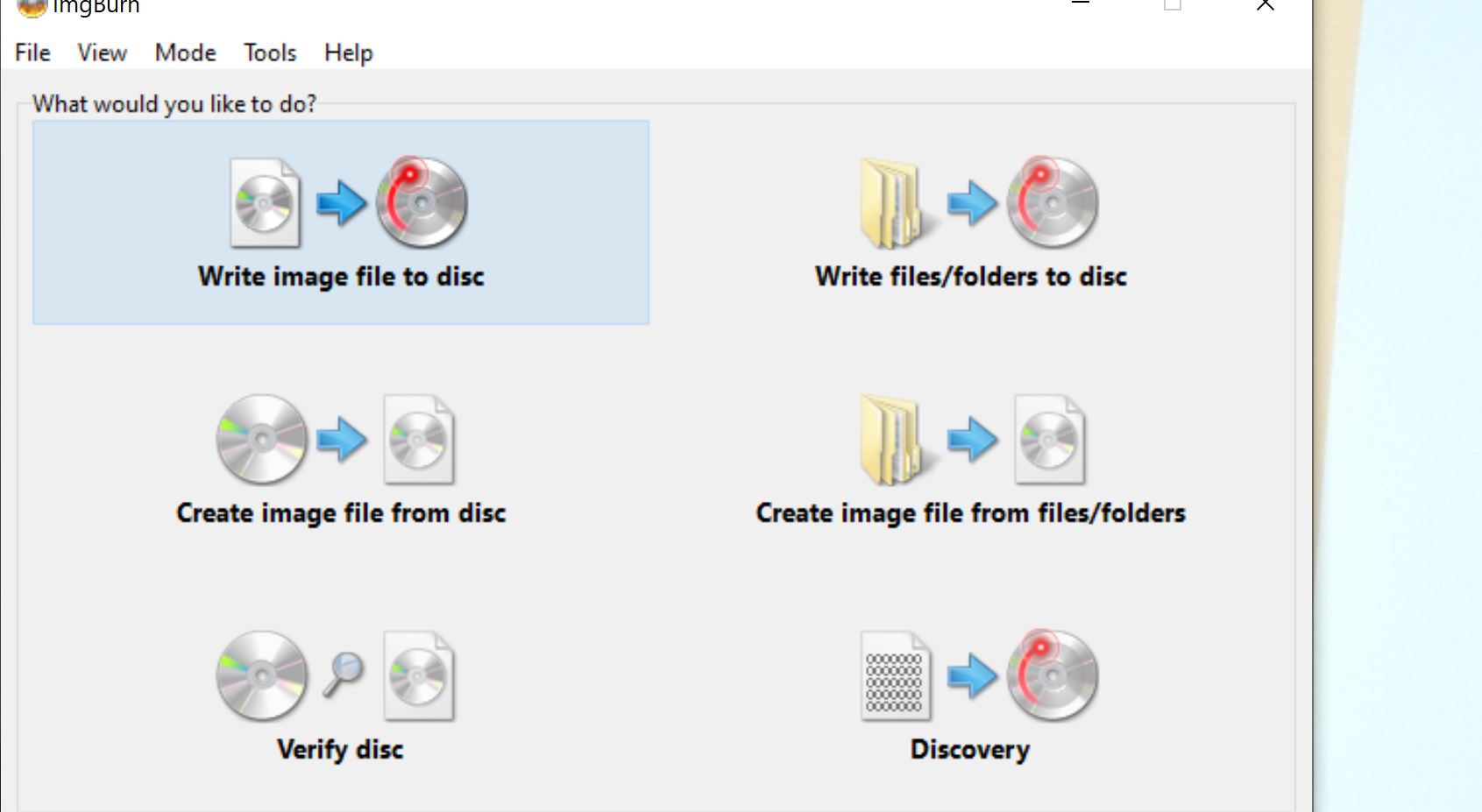

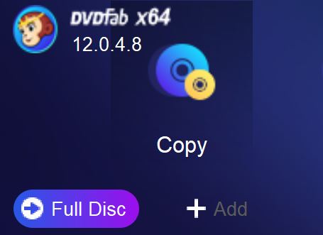

    Did a test with ISO file converted using dvd fab copy and save as iso file
    used imageburn and burnt at 2x speed using write image to disc function
    used asus burner ASUS BW-16D1HT 3.00 (E (SATA) connected via a external case connected to pc via usb
    burnt was successful but when verifying burn got error message.
    took disc and placed in OPPO 203 and disc wasn't recognised.
    also used verbatim bdxl disc
    please advise what am I doing wrong as followed all steps provided by several posts here and burn doesn't work.
    will try on another machine
    burn was a 100gb file.
    has anyone tried burning a disc using Ashampoo program if so does this work.

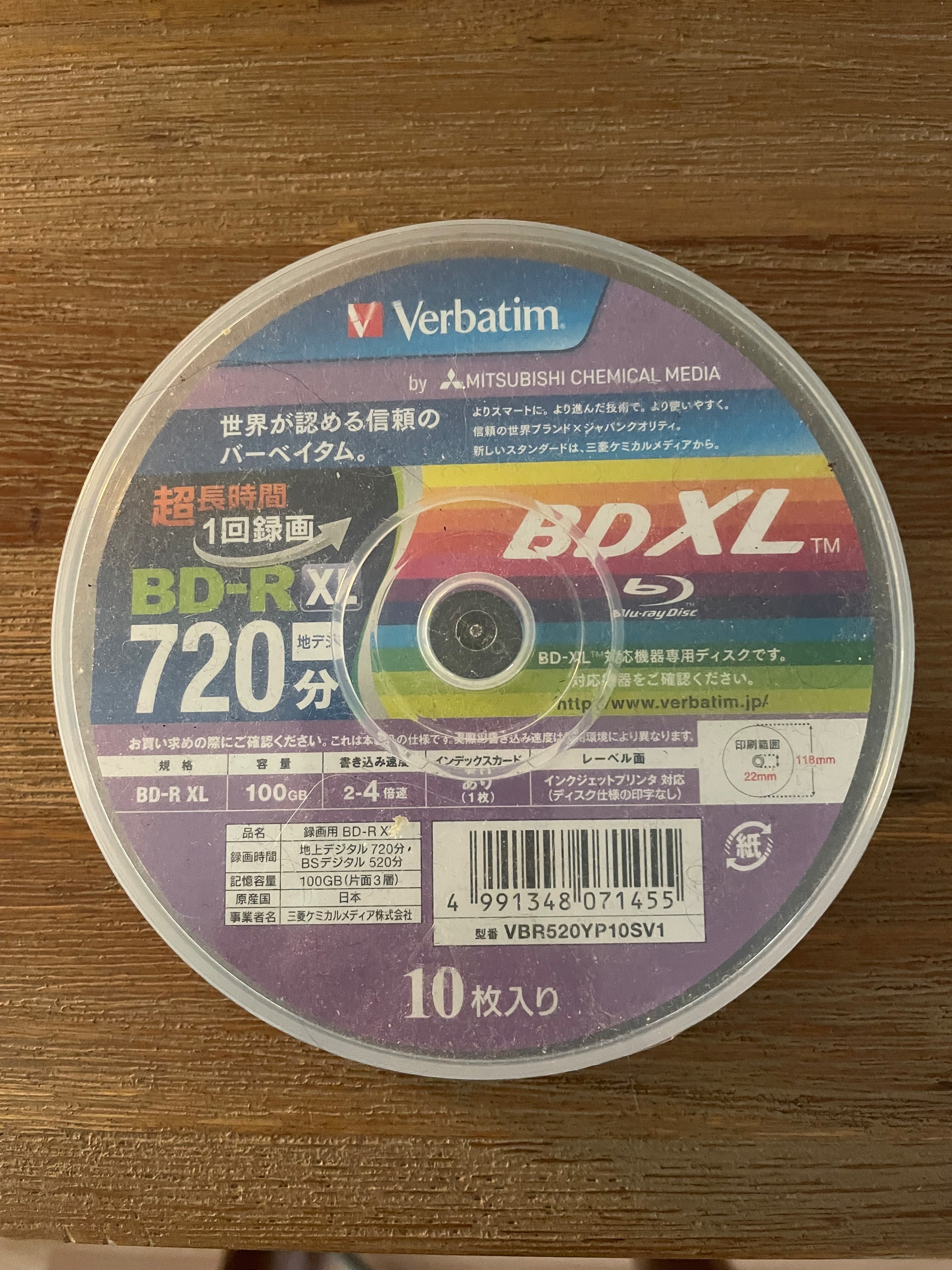

    these are the discs being used
    [Attachment 61085 - Click to enlarge]

    Originally Posted by Kadu7475 View Post
    I did it at 2x speed
    ripped original file to iso using imgburn
    then burnt with imgburn
    using asus burner bdxl via usb
    disabled other drive on pc
    stopped antivirus and also other programs
    tried in oppo 203, xbox series x, panasonuc 450 and sony 700 doesn't read disc
    wasted 3 disc now
    need strict instructions on how to burn these discs.
    otherwise this process doesn't work
    4k movie coping doesn't work properly.

    [Attachment 61332 - Click to enlarge]
    when i burnt this after creating the file to ISO it burnt as a data file and will not read on anything
    [Attachment 61333 - Click to enlarge]
    if i could get again step by step instructions it would help as i am wasting expensive discs.

    I even burnt an iso converted with imgeburn using Ashampoo Nero and DVD Fab and all failed to read in any machine.

    But I got Oppo-203 and my Imgburn method is working perfectly on it. With 66Gb and 100GB discs.
    Burner connected to USB 2.0 Port (a usb 2.0 controller is preffered also), Verbatim BDXL (Mdisc or regular), Imgburn UDF 2.6. works greate 95% of the times.
    Using DVDFab for burning is a sure coaster!
