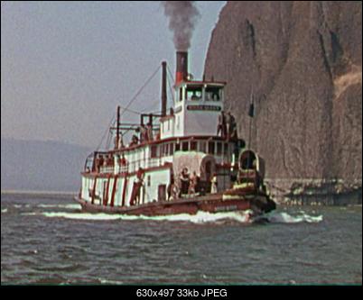

    This image is taken from a bluray version of a film.
    Have a look at the green invasion into many areas, I think it's called fringing, but I'm not sure.
    Apparently it was badly captured during the film/video conversion, with a misaligned camera.
    A friend of mine told that it's possible to correct that, possibly using a Virtualdub plugin. Is that true?
    How should I proceed?

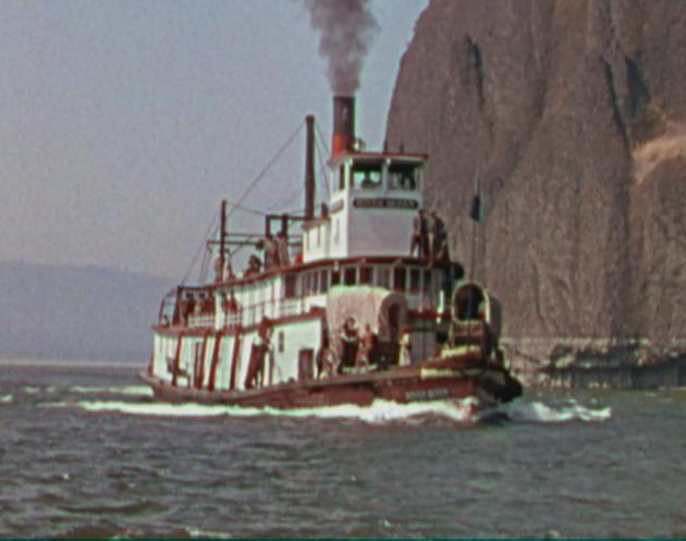

  2. Shifting the red channel up by a few lines helps. I don't know if there's a VirtualDub filter for this but in AviSynth:
    ImageSource("Bend.jpg")
    red = ShowRed() # separate red, green, blue channels
    green = ShowGreen()
    blue = ShowBlue()
    red = red.Crop(0,2,0,0).AddBorders(0,0,0,2) #shift red up by two lines
    MergeRGB(red, green, blue) # merge red,green,blue back together
