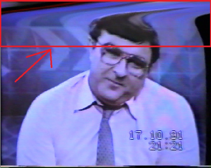

These are examples of flagging/tearing I found in other threads here:
https://forum.videohelp.com/attachment.php?attachmentid=14604&d=1352232607
https://forum.videohelp.com/threads/347549-Screen-Tearing-TBC-Problems-on-JVC-HM-DH40000U
https://forum.videohelp.com/threads/319420-Who-uses-a-DVD-recorder-as-a-line-TBC-and-w...er#post1983288
https://forum.videohelp.com/threads/331681-s-video-artifacts/page4#post2141386Ignore list: hello_hello, tried, TechLord, Snoopy329 -
