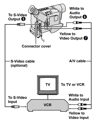

Hello everyone!
I have just about finished capturing all of my VHS tapes from 1986 to 2002 using the StarTech USB3HDCAP and my Toshiba VCR player. It is coming along wonderfully!!!
Now I'm ready to move on to VHS-C tapes that were taken from 2002 to 2011. I do still have the original video camera that filmed these tapes, the JVC GR-SXM240u. However, unfortunately, it appears that this camera cannot be used in the capture process, as there are literally no inputs or outputs on this camera.
I'm looking to obtain the best quality capture for these videos. Given that the original video camera can't be used, which of the following 2 options would provide the best quality capture?
1) For me to purchase a different VHS-C camcorder (a model that has S-Video capability) to use for capturing these videos.
2) For me to use an adapter combined with my Toshiba VCR player. I do have the JVC C-P7U Cassette Adapter, which is actually the original adapter that came with the JVC camcorder. I used to use it all the time to watch the videos on my TV, and I never had a problem with it eating the tapes or anything of that sort, at least not 15 years ago).

I'm looking at the manual and it shows s-video, composite, and mono audio outputs under the connector cover which is on the right side just below the viewfinder.
[Attachment 45288 - Click to enlarge] -
No kidding, I can't believe I missed that!! Thank you so much JVRaines, I really appreciate you finding that!!
Would I be correct in assuming that it would likely be better for me to capture using the original JVC GR-SXM240u for capturing as opposed to my JVC C-P7U Cassette Adapter combined with my Toshiba VCR?
To be honest, I feel like it'd be easier to capture with the JVC C-P7U Cassette Adapter and my Toshiba VCR since that's more similar to what I've been doing all along. However, I'll certainly capture from the original camera if it'll deliver better quality. What exactly are the benefits from capturing from the original camera?
Thanks so much again for all the help!! I can't believe how much I've learned from the support of this board. -
As rule of thumb, it's better to play back on the device which made the recording. Very small differences in tape path alignment and tension can introduce errors. However, if the camcorder has gone out of alignment since the recordings were made or is otherwise degraded, that would be a reason to use the VCR. Another reason would be if the VCR has superior signal processing. I would try both and pick the one with the best picture. If there is no difference, then I would pick the most convenient one.
