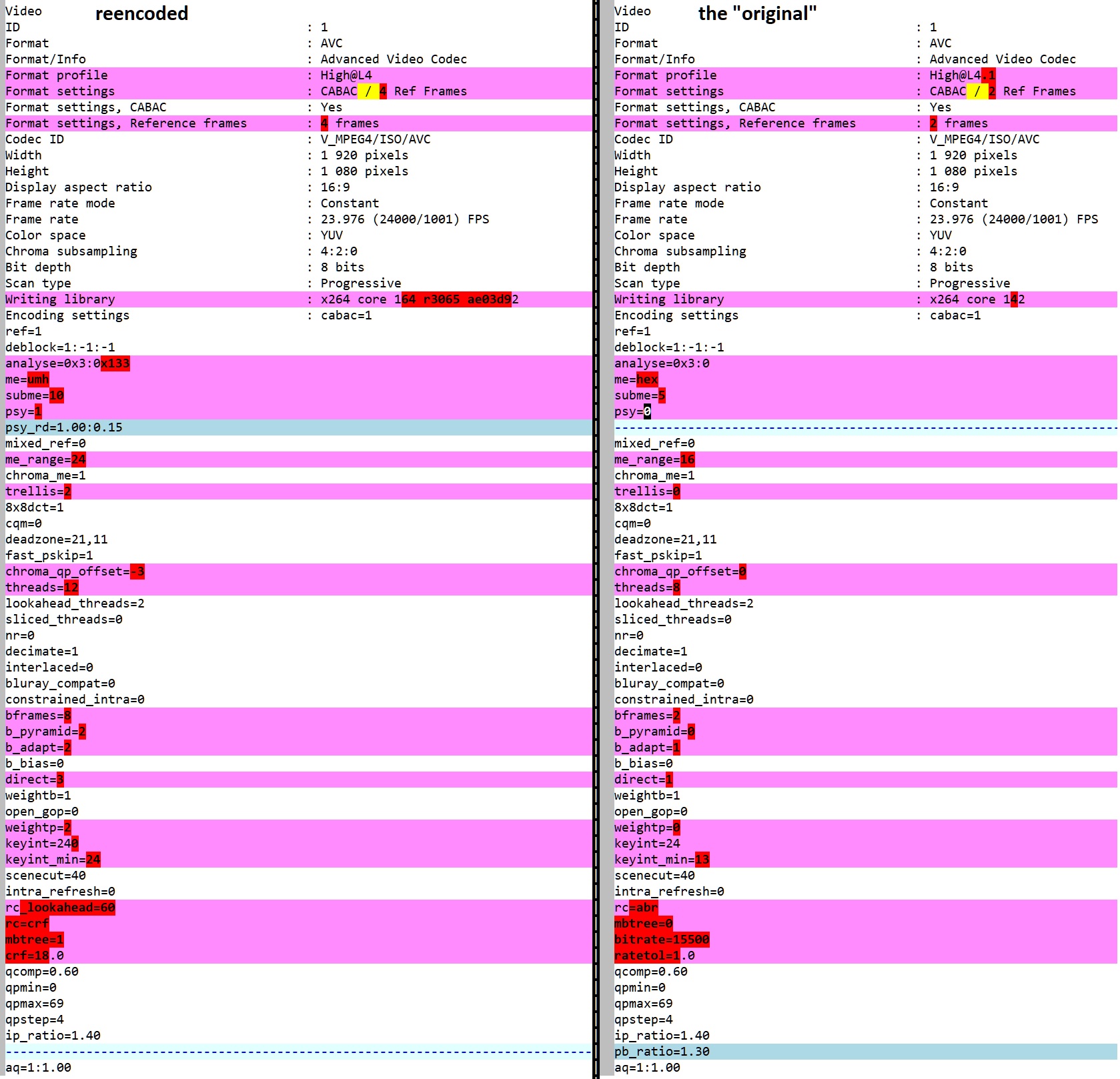

  6. It may sound ridiculous but I guess the "original" was encoded in a fancy way I can't figure out. In the picture I put the encoding parameters side by side. Is there anything able to create the situation you see in the previous picture?
    Thank you.
    [Attachment 62888 - Click to enlarge]
  7. Its the same explanation as the previous post. Nothing fancy.
    The "original" has keyint 24 . The re-encode has keyint 240 .
    The max GOP size of the "original" is 24, the max GOP size of re-encode is 240
    --keyint is the maximum keyframe interval. The encoder will be forced to place an new I frame every 24 frames (or earlier if there is a scene change detected, if scenecut is enabled)
    Because the re-encode places lower quality p and b frames with higher quantizers at most those 24 frame positions relative to the source, you see dips in the quality measurement at those positions as seen in the metrics (Whether or not you actually "see" the dips in normal viewing is another discussion)
    (The "original" is not the actual original BD either - it's not using BD compliant settings, and uses a low bitrate and x264)

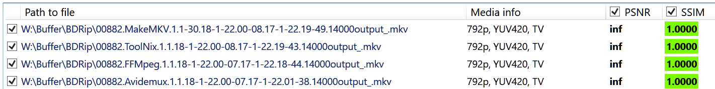

    1. Took an ISO
    2. Identified the main title
    3. extracted the video stream with Avidemux, MakeMKV, Mkvmerge, FFmpeg
    4. MakeMKV and Mkvmerge output files almost identical. Avidemux, smaller, FFmpeg larger
    5. MakeMKV, Mkvmerge and FFMPEG had the same PSNR etc.
    6. I guess it is a problem with the filler data
    7. I also guess that FFmetrics (using FFmpeg's PSNR) do/es a lousy job in evaluating metrics "objectively"
    Is there a better way to do this evaluation?
    LE: funny thing. Encoding with Handbrake those 4 different files, same settings, of course, the re-encoded files are very similar. And absolutely the same quality parameters. Which means the useful data in the stream is correctly taken out regardless of the ripping method. Just the 'associated" garbage is different each time.
    [Attachment 62949 - Click to enlarge]
  10. You would expect remuxing to give the same result
    You showed the VMAF chart, but how low does the PSNR (db) go on those dips ? If the delta is very large, it suggests an error in measurement or encoding
    You can try lossless encoding, if it's not lossless, then it could be the timestamps issue (comparing different frames) - ie. whatever procedure you're using to either encode or decode or analyze is flawed (wrong frame), then you have to examine it more closely at each stage
    BTW , FFmpeg supports libvmaf as well . FFmpeg metrics are "objective" - ie. repeatable if the timestamps are ok, and the container timebase differences are corrected for. Otherwise you get unexpected results (wrong timestamps, wrong frames compared)

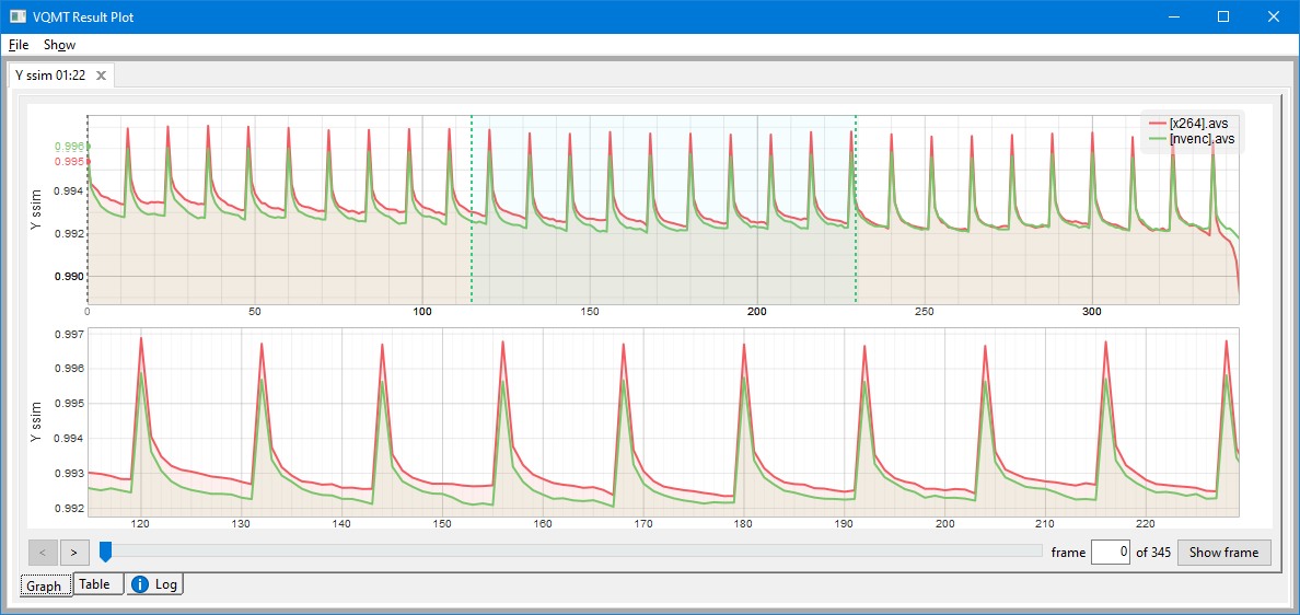

Name:	msu vqmt plot.jpg
  12. That last ssim plot looks "normal" to me . The peaks are I frames
  13. Originally Posted by poisondeathray View Post
    You can try lossless encoding, ... FFmpeg metrics are "objective"
    Well, in this very moment I just want the extracted mkv to have PSNR inf when compared to original m2ts.
    FFmpeg can manage to remove the filler data or whatever it is but cannot manage the PSNR measurement.

    step 1. m2ts compared to the extracted mkv should show PSNR INFinite. not -1db not -0.01dB. If not, my FFmpeg based tool is simply not good. Can't move to step 2.
    So, right now, I'm looking for a tool that loads the video stream from m2ts, compares it with the stream from the extracted mkv and shows PSNR INFinite, SSIM 1.
