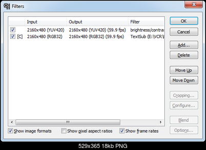

    I have frames I'm trying to hide with typography overlays that I add using the TextSub filter. So even with this small difference, the out of place frames are actually apparent even at regular playback speed because the original typography that I don't want to be visible is usually different enough in appearance so that it can be seen briefly flashing (for 1 frame).

    So maybe the problem is with your subtitling software?
    A quick fix might be to simply delay (pos or neg) all subtitle timings by 1 or 2 ms using e.g. SubtitleEdit to account for the small difference.

  19. Originally Posted by lomaidala View Post
    So ConvertToRGB?
    Check to see what colorspace your VirtualDub filters are using. Its Filters dialog will show that if you tick "Show Image Formats".
    Do I still need the (interlaced=true) part?
    I already told you: after QTGMC your video is no longer interlaced.
    So ConvertToRGB?
    [Attachment 44808 - Click to enlarge]
    So are you saying that when using filters, the color space the filter indicates determines what color space I should convert to in my AVS script? It says RGB32 for both input and output. Does that mean I shouldn't be putting any color space conversion in my script?
    I can't speak for jagabo, but to avoid colorspace conversions I avoid the use of VDub filters. The Textsub filter in the picture has an AviSynth equivalent so why on earth would you even consider using the VDub version? Besides requiring 2 slightly degrading colorspace conversions, the encoding is noticeably slower.
