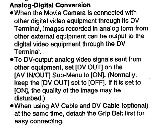

One last query. Some camcorders had the passthrough disabled in european versions.
Is it likely to be the case with the GS400? Is there a way of checking if that’s the case before purchasing a second hand one. -
I doubt it. According to the GS 400 manual from Manualslib, it does AV>DV Passthrough (page 61):Originally Posted by JN
[Attachment 82165 - Click to enlarge]
You could ask the seller to check that "DV OUT" is shown in the menu (as per dot point 2).
