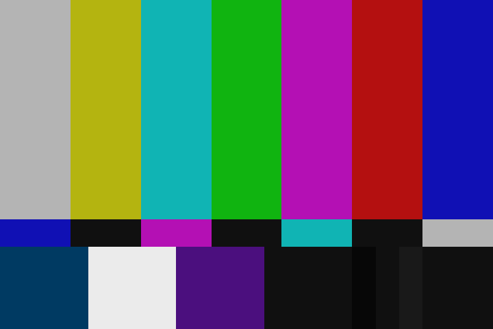

    Another thing I couldn't figure it out by my self is how to make this work like this professional pattern tapes I had, the B&W screen is true B&W or grayscale, it has no color information on it, is possible to confirm this with a oscilloscope. I've converted this to different file formats, created a DVD and I could not get rid of the color signal from this screen.
    The Color Bars works great.

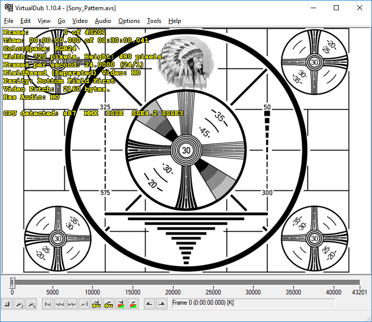

    The monosco is another history, can't get rid of the chroma signal.
    The original monosco test pattern test generates a signal like this that I use this to align the tape guides.
    How to create a B&W video of this pattern?
