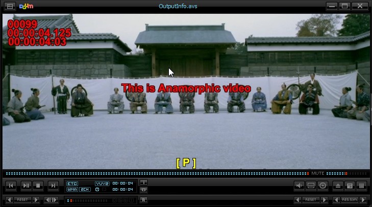

    To start in the middle of a video you will have to know the time of that frame. The image below shows the output of the above script ending at 0-99 frames.
    POTPLAYER or other player that accepts AVS file
    [Attachment 44762 - Click to enlarge]

    How are you finding the frame number? If you are scanning the video to find you could use the showframe/showtime options as shown in my image above.

    Thanks Budman1 for the frame time tip and example image -- what's the video player there to be used with showframe/showtime?

    @chconnor... Any video player that supports AVISYNTH 'AVS' file playing will work. You just need the Avisynth script that I forgot to include in my thread.
    FFmpegSource2("C:\Users\Bud\Documents\Applian\Replay Media Catcher\Video.mp4", atrack=-1).Crop(0,0,-0,-0).LanczosResize(720,404)
    ScriptClip(Last, """Subtitle("[ "+Chr(FFPICT_TYPE)+" ]", size=(Height*56.0/720), align=2)""", after_frame=true)
    Subtitle("C:\Users\Bud\Documents\Applian\Replay Media Catcher\Video.mp4", x=720, y=424, font="Arial", size=24, text_color=$ff0000, align=3)
    ShowFrameNumber(scroll=true, x=10, y=27, font="Arial", size=24, text_color=$ff0000)
    ShowTime(x=72, y=44, font="Arial", size=24, text_color=$ff0000)
    ShowSMPTE(fps=29.97, x=68, y=61, font="Arial", size=24, text_color=$ff0000)
    The attributes for each line is set automatically by my program for the video size and for alignment of the text. If you adjust the font size or have a different video size, the output will be different but should still be readable.
