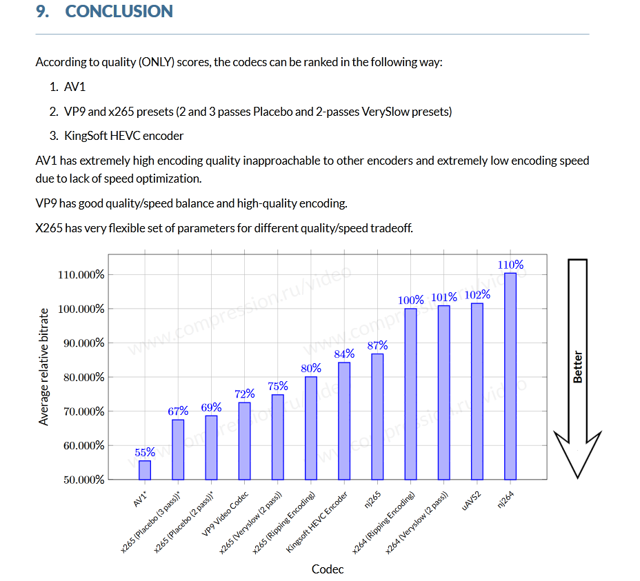

    MSU last month released results from another codec test, this time including the soon to be frozen AV1 (they used Version 0.1.0). Ignoring encoding speed, they found AV1 to be a clear winner at bitrate/quality efficiency.
    [Attachment 44748 - Click to enlarge]
    http://www.compression.ru/video/codec_comparison/hevc_2017/MSU_HEVC_comparison_2017_P5...Q_encoders.pdf
    A few weeks ago I did my own visual AV1/x265/x264 tests and found AV1 at the absolute slowest settings to be obviously better than x265 placebo, but I was measuring encoding speed in a few frames a minute. When using the --good preset in AV1, it gave me a more normal 4 frame per second encoding but the line between --good AV1 and placebo x265 is barely there, making x265 still very worthwhile. Not to mention nothing can really play AV1, so I had to decode my encodings into raw YV12; and it still has not be standardized yet. In my experience AV1 is single thread only encoding, no matter how many threads I tell it to use.

    AV1 is better, ignoring the massive amount of time it takes to encode with the slowest settings.
    x265 is still better in the real world considering it has had 5 years of maturity and massive speed upgrades from better use of lower level assembly instruction sets, while the AV1 (AOMedia) encoder is for a standard that does not even exist yet. People tend to forget how slow the reference encoder for HEVC was before standardization.
    I found x265 @placebo to be on par (more or less) with AV1 (AOMedia Codec) using the --good setting (which is some kind general fast setting). --good gave me ~4 frames per SECOND. So with the wide support for HEVC, the multicore support, and faster encodings make x265 better. AV1 wins however when using the default slowest settings which gave me like 2 frames per MINUTE, single core. The default slowest was noticeably cleaner and retained more detail. As with x264/x265/libvpx, we are just going to have to wait for the encoder to be optimized.
