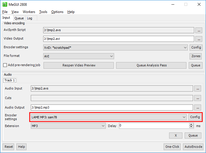

    Save this file as LAME MP3_dp_ sam78.xml at Megui > allprofiles > LAME MP3
    <?xml version="1.0"?>
    <GenericProfileOfMP3Settings xmlns:xsi="http://www.w3.org/2001/XMLSchema-instance" xmlns:xsd="http://www.w3.org/2001/XMLSchema">
      <Name>sam78</Name>
      <Settings>
        <PreferredDecoderString>LWLibavAudioSource</PreferredDecoderString>
        <DownmixMode>StereoDownmix</DownmixMode>
        <BitrateMode>ABR</BitrateMode>
        <Bitrate>128</Bitrate>
        <AutoGain>true</AutoGain>
        <SampleRateType>deprecated</SampleRateType>
        <SampleRate>KeepOriginal</SampleRate>
        <TimeModification>KeepOriginal</TimeModification>
        <ApplyDRC>false</ApplyDRC>
        <Normalize>100</Normalize>
        <CustomEncoderOptions>-m j -V 4 -q 3 --lowpass 13.5 --abr 80 --resample 48</CustomEncoderOptions>
        <Quality>4</Quality>
        <AbrBitrate>128</AbrBitrate>
      </Settings>
    </GenericProfileOfMP3Settings>
    Load the Preset LAME MP3: sam78 and encode whatever you need with the settings you want.
  7. @amaipaipai Nice explaination thank you so much. I have some doubts! If we want to change audio bitrate 96 or 128 or sample rate 41.0 khz or 48.0 khz then we need to edit that xml commands every time or we can make changes directly using megui config button that we can see in the above image right side, marked with red line.
