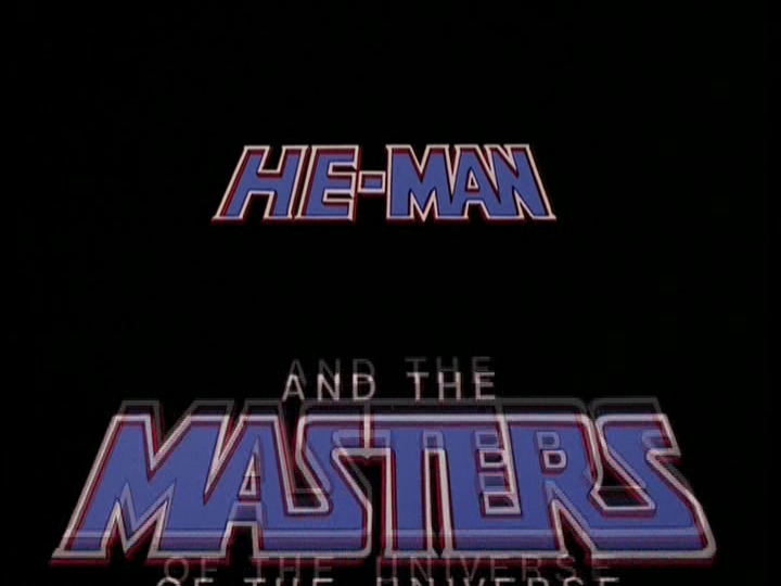

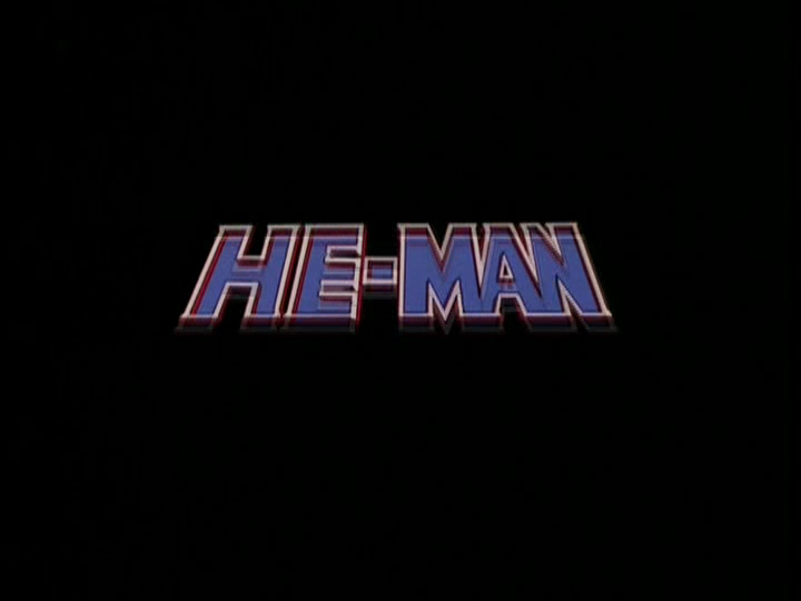

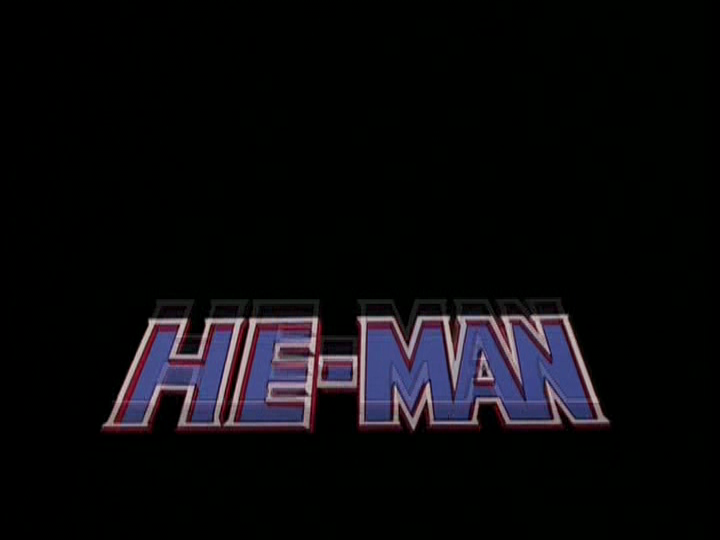

    Dear all,
    I am currently watching all my 80's cartoons and what I have noticed is during scenes with motion, there is this blurring effect. I think the term for this is called de-interlacing or interlacing.
    I have attached sample screenshots and video so you know what I mean.
    My question to yourselves is there such a dvd/blu ray player that will play the dvd correcting this problem? Or does this not exist? I was thinking along the lines of a player with a deinterlace feature or something like that.
    I currently have a sony bdp s1200.
    If a dvd aplayer that fixes this problem does not exist, then the question is 'how do I watch these cartoons without this distracting issue?' Is there a 3rd party device I can purchase that will iron out the issue?
    If the above does not exist my only option is to rip the dvd's and fix them myself with yadif but is going to be incredibly time consuming as I have 100's of episodes from different cartoons. This is even noticeable on Marvel 90's cartoon DVD's such as Spiderman and X-men animated series.
    Thanks in advance!

    The original DVDs have no such issues that I'm aware of.
    Aug 2010
    Leicester, England
    Tell me about it! The treatment of some of these dvds is terrible. I just ran a test to repair them with avisynth, but I'm not skilled enough to remaster these.
  4. It's already been deinterlaced. Both your DVD player and your television have deinterlacers built in. What's causing it is field-blending from a poor conversion of a PAL source to NTSC. The way - the only way - to fix it is with an AviSynth unblending script. Here's the important part of the one I used:
    QTGMC()
    SRestore()
    In the future, when sending samples please get the M2V directly from the DVD without repacking it as MKV. And please choose a section from the body of the episode. The intros are often done differently from the episodes themselves.

  30. davexnet already mentioned your new source is progressive and the fields have already been blended together. That is, there's no point in bobbing it as both fields/frames will be identical. It's already been blend deinterlaced. This is something you could have easily discovered for yourself by putting on the bobber alone.
    To further complicate things, it was blend deinterlaced from a PAL source. SRestore does have a mode that fixes blend deinterlacing, but from NTSC sources (2 of 5 frames blended together). ExBlend does claim to be able to fix blend deinterlacing from PAL sources (2 of 6 frames blended together), and it's worked for me in the past, but in this case it didn't work worth a damn. Unless someone comes up with something else, I think this one can't be fixed.
