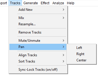

    I agree; the menu items are still available but they have been 'buried' in the menus:
    http://alphamanual.audacityteam.org/man/Tracks_Menu#Pan_.C2.A0
    [Attachment 44726 - Click to enlarge]
  6. Originally Posted by raffriff42 View Post
    maybe the left/right channel options were removed for being potentially confusing?
    Ah yes.....
    Although I'm not sure that's the same as the old left/right channel options because when using the Tracks/Pan/Left,Right,Centre menu it adjusts the pan slider for the selected tracks accordingly, whereas previously I think the pan slider remained in the centre.
    Is it just me or is the new GUI look somewhat fugly? At least it does on XP with the "classic" Windows theme because it's a mixture of two styles. I've never been a fan of the "flat look". I'd hoped it was a phase that would pass fairly quickly.
    Many thanks.
    Personally, I find the use of the term "Pan" non-inuitive, but then I'm not a professional audio person nor am I the software author. But given that I obviously didn't just immediately investigate the Tracks menu in my hunt for where the feature would now be located, and select that PAN item assuming that's where I would find the LEFT/RIGHT/MONO control... well, to be honest, I think the choice of "PAN" as the heading wasn't something I would have guessed at. I don't know why it was moved from the dropdown list heading each track itself (where even rookie me found it immediately, investigating what that down-arrow FOR THIS SPECIFIC TRACK would reveal), but if they took an opinion poll I would vote "negative" on whether this was a good change or not. I honestly question why it had to be disappeared from that down-arrow list at all, even if PAN was to be added to the Tracks menu.
    Oh well.
    And once the LEFT or RIGHT is selected and the "channel" graphic on the track simultaneously moves, I now assume I could have just directly pulled that "pan" slider (drawn on each track) all the way left or right in the first place to accomplish the identical result of designating the nature of this track. I probably didn't need to use the dropdown arrow menu with the old 2.0.6, and I probably don't need to use the Tracks -> PAN flyout with 2.2.1. But then I'm not fluent in Audacity, so once a long time ago when I learned how to accomplish what I wanted to accomplish, I just never experimented further.
