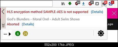

    Here are the direct .m3u8 files with SAMPLE-AES encryption. The master files have info for all resolutions and the Layer 6 files are supposed to be in 720p.
    Offensiveness
    http://tve-vod.cdn.turner.com/adultswim/5219209fb9b00585da914ff30104c6e200000000/master_pt_de.m3u8
    http://tve-vod.cdn.turner.com/adultswim/5219209fb9b00585da914ff30104c6e200000000/layer6/layer6_pt.m3u8
    God's Blunders
    http://tve-vod.cdn.turner.com/adultswim/f688f9b0cbd34004fb02c5580342d08f00000000/layer6/layer6_pt.m3u8
    http://tve-vod.cdn.turner.com/adultswim/f688f9b0cbd34004fb02c5580342d08f00000000/master_pt_de.m3u8
    Pleasure
    http://tve-vod.cdn.turner.com/adultswim/6806d293fbe305ab83fb1e3a0a22d08e00000000/layer6/layer6_pt.m3u8
    http://tve-vod.cdn.turner.com/adultswim/6806d293fbe305ab83fb1e3a0a22d08e00000000/master_pt_de.m3u8
    The Lord's Prayer
    http://tve-vod.cdn.turner.com/adultswim/88c75d3e4b41e16568b9477305c3e20400000000/layer6/layer6_pt.m3u8
    http://tve-vod.cdn.turner.com/adultswim/88c75d3e4b41e16568b9477305c3e20400000000/master_pt_de.m3u8
    Holy Visage
    http://tve-vod.cdn.turner.com/adultswim/be10eb15400ffd24de310c9609ffe66f00000000/layer6/layer6_pt.m3u8
    http://tve-vod.cdn.turner.com/adultswim/be10eb15400ffd24de310c9609ffe66f00000000/master_pt_de.m3u8

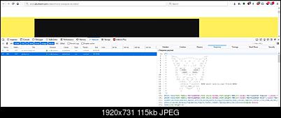

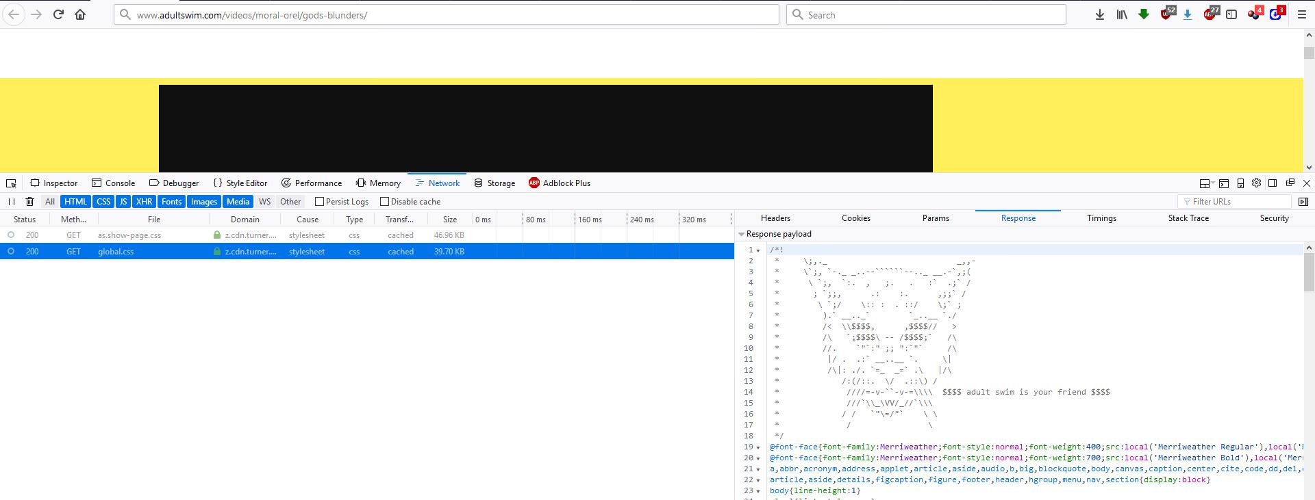

  13. Browser -> F12. Find the network request with the address „http://tve-vod.cdn.turner.com/adultswim/f688f9b0cbd34004fb02c5580342d08f00000000/layer...ayer6_pt.m3u8“. Look in the „Response“ playlist content. Show part of it here.

  15. Originally Posted by LZAA View Post
    Are you talking about this?
    I couldn't find anything inside the code referring to .m3u8 files or playlists.

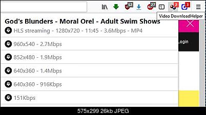

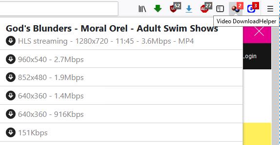

    I used cmd.exe with youtube-dl and typed in:
    youtube-dl --list-formats http://www.adultswim.com/videos/moral-orel/gods-blunders --ap-mso=Comcast_SSO --ap-username=XFINITYUSERNAME --ap-password=XFINITYPASSWORD
    I was then given these options:
    [AdultSwim] gods-blunders: Downloading webpage
    [AdultSwim] azuZUAzMTYuLO7AVGekS9Q: Downloading XML
    [AdultSwim] 653296: Retrieving Media Token
    [AdultSwim] 653296: Downloading XML
    [AdultSwim] 653296: Downloading m3u8 information
    WARNING: Failed to download m3u8 information: HTTP Error 403: Forbidden
    [info] Available formats for azuZUAzMTYuLO7AVGekS9Q:
    format code  extension  resolution note
    ipad-64      mp4        unknown      64k
    iphone-64    mp4        unknown      64k
    iphone-274   mp4        416x240     274k
    ipad-476     mp4        416x240     476k
    iphone-476   mp4        416x240     476k
    hls-886      mp4        640x360     886k
    ipad-886     mp4        640x360     886k
    iphone-886   mp4        640x360     886k
    hls-1503     mp4        640x360    1503k
    ipad-1503    mp4        640x360    1503k
    iphone-1503  mp4        640x360    1503k
    hls-2011     mp4        848x480    2011k
    ipad-2011    mp4        848x480    2011k
    iphone-2011  mp4        848x480    2011k  (best)
    Then I typed:
    youtube-dl http://www.adultswim.com/videos/moral-orel/gods-blunders --ap-mso=Comcast_SSO --ap-username=XFINITYUSERNAME --ap-password=XFINITYPASSWORD
    I was able to download the best 480p file of medium quality. But the main problem is it's not in HD 720p format. If you look at one of the pictures I posted above, my VideoDownloadHelper add-on offered me a 720p resolution download. It seems the 720p download isn't available with TVDownloader or YouTube-dl either.

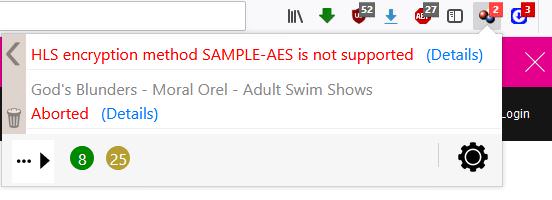

  16. Take the link from the Video-DownloadHelper and paste in the youtube-dl.
  17. Originally Posted by LZAA View Post
    I already posted the .m3u8 link (with the HD 720p option) in youtube-dl, but it keeps saying this over and over again:
    [hls,applehttp @ 0357afe0] SAMPLE-AES encryption is not supported yet
    [hls,applehttp @ 0357afe0] Failed to open segment of playlist 0
