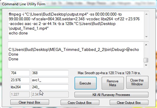

Thanks everyone for help. I tried all possibilities since this was a good test video being VFR and a little odd working with it and playing compared to others. I was able to modify an avisynth script using a combination of the posts by Poisondeathray and Davexnet.
Then I used a crude ffmpeg script just to test and got a video that is perfectly in sync now and the correct size.Code:video2 = directshowsource("c:\users\bud\desktop\[dp]Manjandani-1.mp4", fps=23.976, convertfps=true, audio=true) Video1 = directshowsource("c:\users\bud\desktop\output.mp4") Video1 = Video1.ConvertToYV12() Video2 = Video2.ConvertToYV12() a=video1 b=video2 b=b.blackmanresize(a.width,a.height) # fix mismatch size b=b.assumefps(a.framerate,sync_audio=true).ResampleAudio(a.AudioRate) # fix mismatch frame rate and audio sample rate return a+b
[Attachment 44711 - Click to enlarge]
The number of frames shown above for the 10 second video was 240 (23.976 x 10) but I assume thats as close as it could get to 239.76 frames and only results in an extra 11 ms for video 1. It doesn't seem to affect video 2 after it is joined so no biggie.
