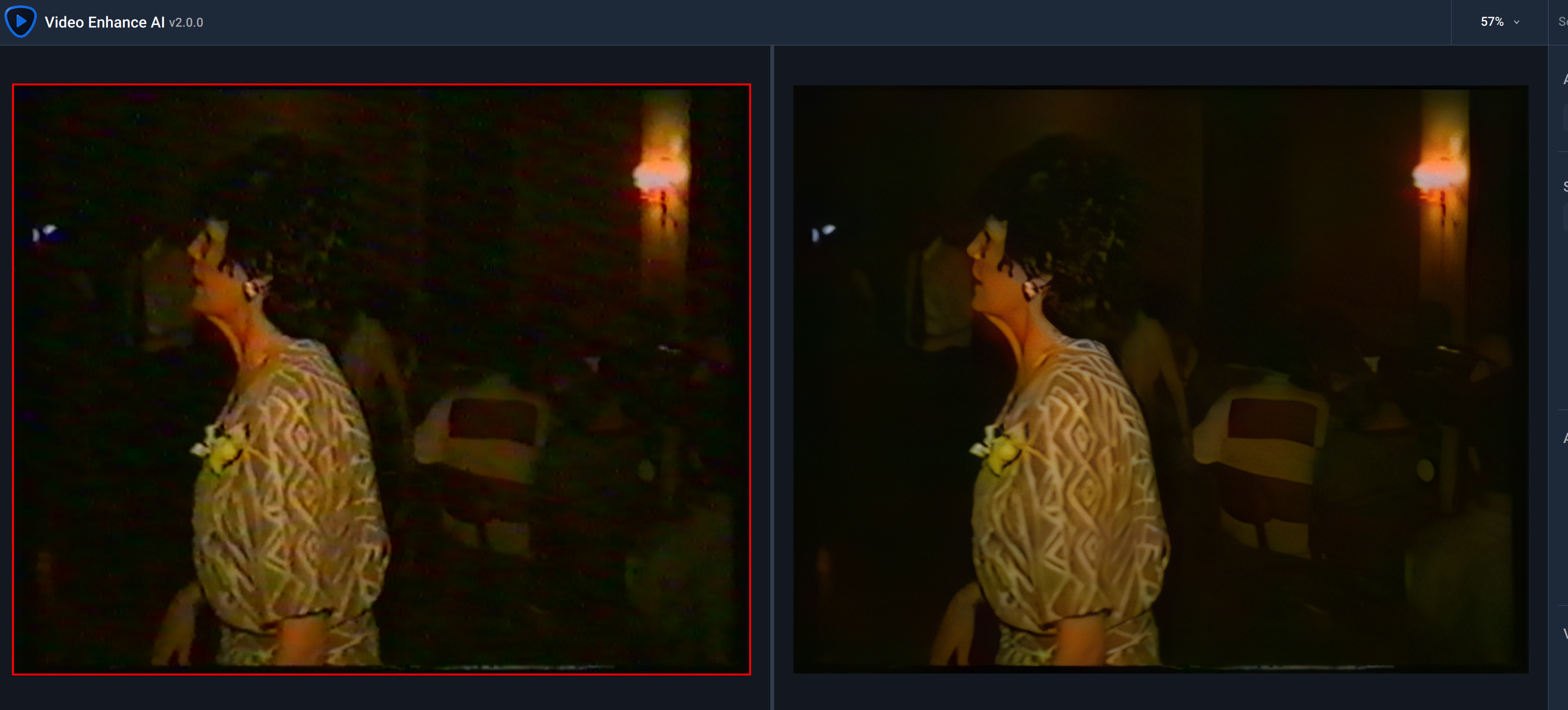

    This is an old if still a useful thread. For those who are interested Topaz labs have added deinterlacing to their fancy Topaz Video Enhance software.
    Although if you are purists you may be horrified but the AI algorithms can do amazing things with video to enhance, denoise and upscale it. I have no idea how the deinterlace works but it can result in a nice 50fps 1080p from an interlaced 576i miniDV or PAL recording.
    It recreates details, which can look so clean there is a setting to add noise back in to the video to make it look natural. If you turn up the AI correction too much faces can start to look unnatural (like Max Headroom for my older readers).
    Here is a still from a 1992 2nd generation VHS copy (left image) . My cheap VCR did the deinterlacing on this example but you can see how the Topaz software cleans up the colour noise and "recreates" the patterns on the dress and removes the jaggies and cleans up the purple block on the t shirt ( right image).
    https://forum.videohelp.com/attachment.php?attachmentid=58563&stc=1&d=1619161215
    They sometimes have sales as its usually $300
    https://www.topazlabs.com/video-enhance-ai

  12. You probably could do better with Avisynth/Vapoursynth and the right filter combination and some knowledge about image/video processing&co, but Topaz's software is an easy way to archive decent results. So I see how it might be interesting to some.
