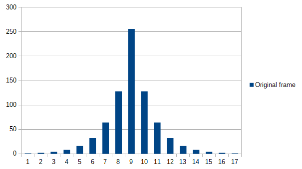

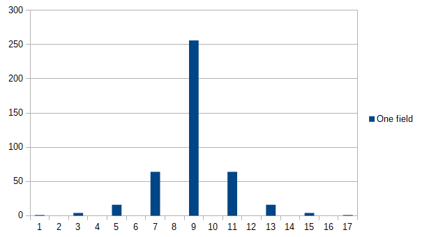

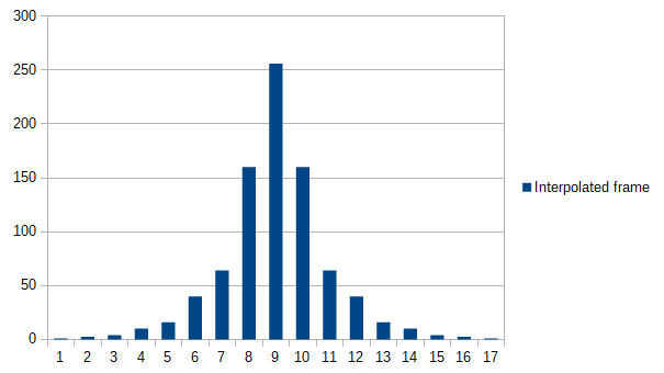

  18. Member Bernix's Avatar
    Apr 2016
    Europe
    Here I create some graphs how i understand lossless deinterlacing.
    Here is original progressive frame.
    [Attachment 44727 - Click to enlarge]
    Here is field from this progressive image
    [Attachment 44728 - Click to enlarge]
    And here is linear interpolation of missing lines
    [Attachment 44729 - Click to enlarge]
    It is not perfect, it is just linear interpolation. But how and why to demolish original lines from one field picture? You can get them from result back. And yes, linear interpolation isn't probably best, but even other non linear methods should keep original values, and don't change them.
    Of course you can refine missing lines from previous - next fields, where missing lines can lean on existing lines (they are also intact there). Question is how, but still lossless.
    Bernix

    Does anybody know how today's TVs or HW deinterlacers process one field phase-shifted "interlaced" video? Do they match the fields and hence restore the original progressive frames perfectly, or do they deinterlace it (producing unavoidable artefacts)?
    Most of modern reputable brands TV's are equipped with some form of motion detection so they should be able to deal with odd cases (but not always without issues). And TV's usually don't know flag (i mean by this that multimedia and TV reception functions are usually processed in different circuit than video thus video processor almost always perform blind deinterlacing). It is mandatory to have motion detection in all framerate converting TV's (and many of them are in fact asynchronous internally with fixed refresh rate when compared to incoming video). IMHO Better brands trying almost everything in approach toward good deinterlacing.
    (and they are quite good, can observe SD interlace on very old LG TV, and interlace they can be seen only in very fast motion areas with relatively low contrast like light gray on white - then some lines can be visible but on limited area - this LG TV is at least 6 years old and modern TV should be way better).
